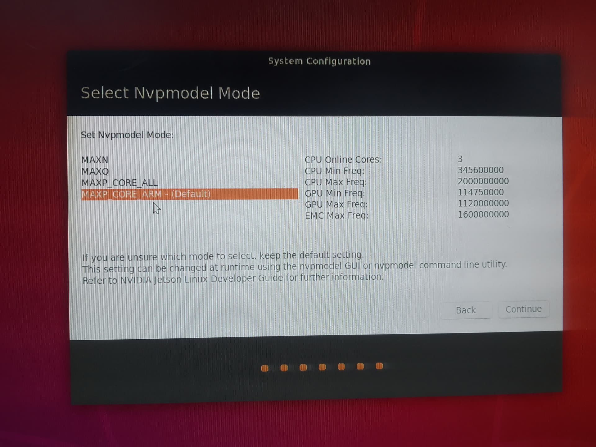

if we choose the default setting (please refer to the following picture), tty log shows CPU1 and CUP2 shutdown.
[ 1068.366532] CPU1: shutdown
[ 1068.438298] CPU2: shutdown
since the tx2 has quad cortex a57 and dual denver. So, which one is CPU1, or CPU2? and why? does the system use cortex a57 by default? is there difference between the process scheduling on cortex a57 and denver? or the denver is banded to GPU i guess.
on the nvpmodel default choosen condition, will the cpu1 and cpu2 be shutdown forever? if not, when will they be waked up?

hello Henry.Lou,
we disable Denver cores by default due to the Denver 2 CPU cores have different performance characteristics than the ARM Cortex-A57 cores.
it’s CPU-1, CPU-2 as Denver cores. you may also check tegrastats, they should be 0% usage even running CPU stress.
please refer to Release Notes (r32.5.1) for [5.15 Increased Kernel Launch Latency on Denver 2 Cores] as see-also.
you needs to remove isolcpus=1-2
in kernel command line to enable Denver cores.

MaxN configure system to performance mode, it doesn’t care about power consumption.
