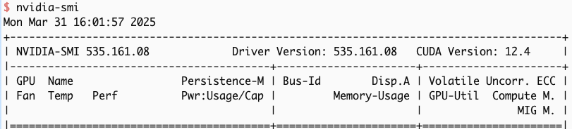

this is the NVIDIA driver version:
I don’t see any nvshmem here, and with respect to the CUDA C++ code that you have shown, this is a known limitation of peer mappings, currently (limited to about 8 GPUs in a peer “clique”). With respect to nvshmem, it is documented that nvshmem requires all GPUs to be P2P accessible. Based on that faq link, it looks like it may be possible to break e.g. a 2 socket 16 GPU node into two “half-nodes” if there is IB connectivity between the two halves (and the 8 GPUs in each half are P2P capable). I don’t have a recipe for you.
