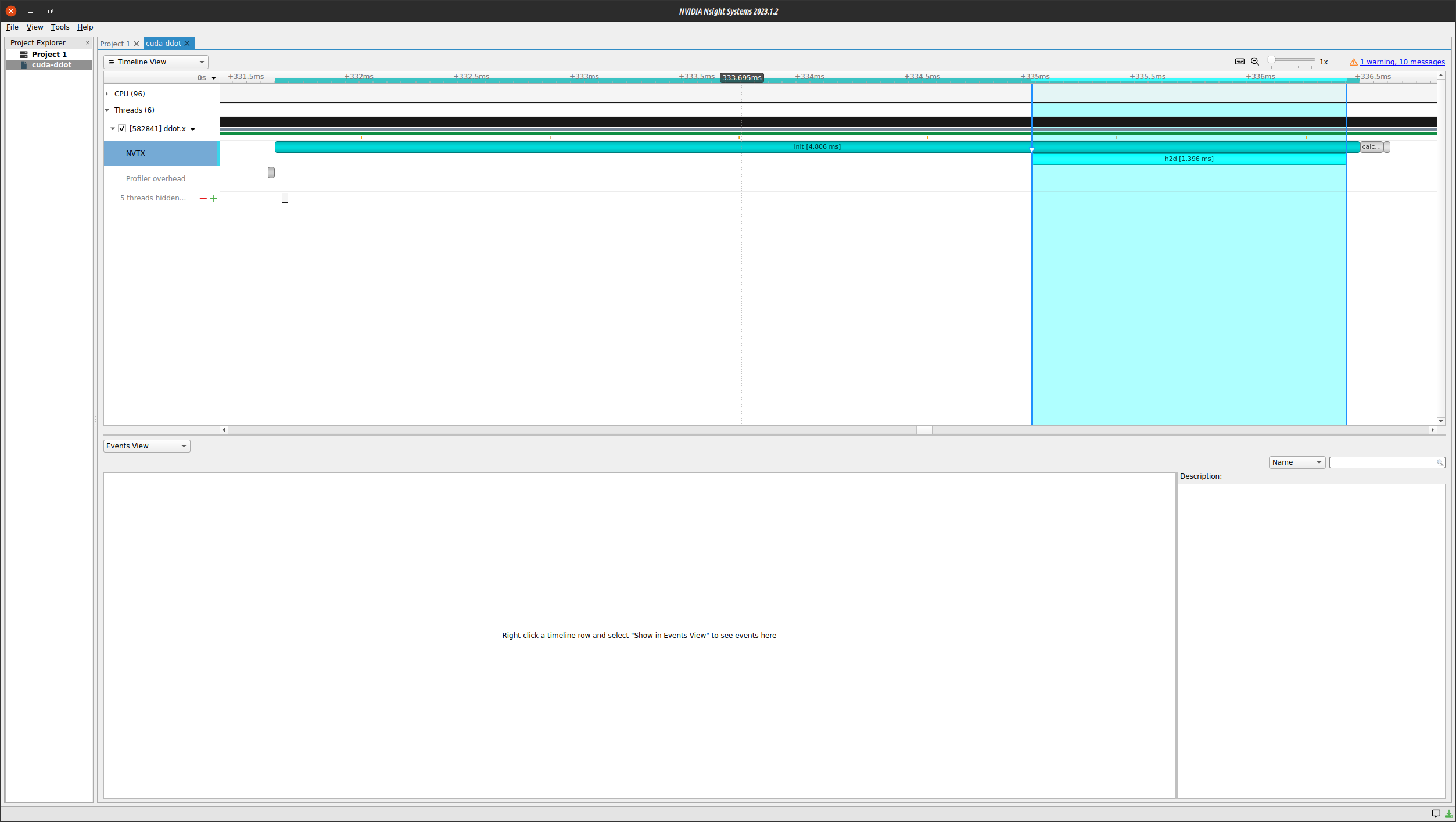

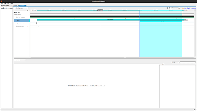

I wish I can ignore the return value, but here’s an interesting bit: when I run the code under Nsight Systems, the error code changes to -1, but Nsight Systems seems to capture the regions correctly!
wp11@ufront:~/work/testcodes/cpp-cu-ddot$ nsys profile -o cuda-ddot --stats=true --trace=nvtx ./ddot.x 1000000
Using device NVIDIA A100-PCIE-40GB
NVTX Error: -1
h_A[999999] = 999999
h_B[999999] = 2e+06
NVTX Error: -1
NVTX Error: -1
NVTX Error: -1
NVTX Error: -1
Kernel 1 (ddot), workspace size = 4096
Using grid: 3907, 1, 1
Using block: 256, 1, 1
Kernel 2 (reduceblocks), workspace size = 4096, filled = 3907
Using grid: 16, 1, 1
Kernel 2 (reduceblocks), workspace size = 16, filled = 16
Using grid: 1, 1, 1
NVTX Error: -1
NVTX Error: -1
NVTX Error: -1
Success! Result = 6.66666e+17

 Time (%)  Total Time (ns)  Instances   Avg (ns)     Med (ns)    Min (ns)   Max (ns)   StdDev (ns)   Style   Range
     76.0        4,806,275          1  4,806,275.0  4,806,275.0  4,806,275  4,806,275          0.0  PushPop  init
     22.1        1,396,473          1  1,396,473.0  1,396,473.0  1,396,473  1,396,473          0.0  PushPop  h2d
      1.6          100,161          1    100,161.0    100,161.0    100,161    100,161          0.0  PushPop  calc
      0.4           24,500          1     24,500.0     24,500.0     24,500     24,500          0.0  PushPop  d2h
