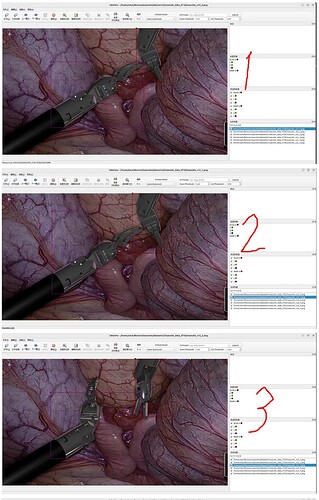

  1. we use headless mode
  2. we use replicator to obtain the bbox position information on image, but they do not match
  3. we use issacim to obtain the 3d positions of a prim and get the 2d coordinates in the image, but the position is not right

Visualization not right

It looks like you’re using Isaac Sim version 2023.1.0-hotfix.1, which is an older, unsupported version.
I recommend trying to reproduce your issue with the latest Isaac Sim 5.0.0 developer preview. This new version is built on Omniverse Kit 107 and includes numerous improvements and bug fixes that might resolve the discrepancies you’re seeing with prime position data and Replicator bbox data.
You can find more information about the latest version on GitHub - isaac-sim/IsaacSim: NVIDIA Isaac Sim™ is an open-source application on NVIDIA Omniverse for developing, simulating, and testing AI-driven robots in realistic virtual environments..
Please let us know if upgrading helps resolve your issue!
