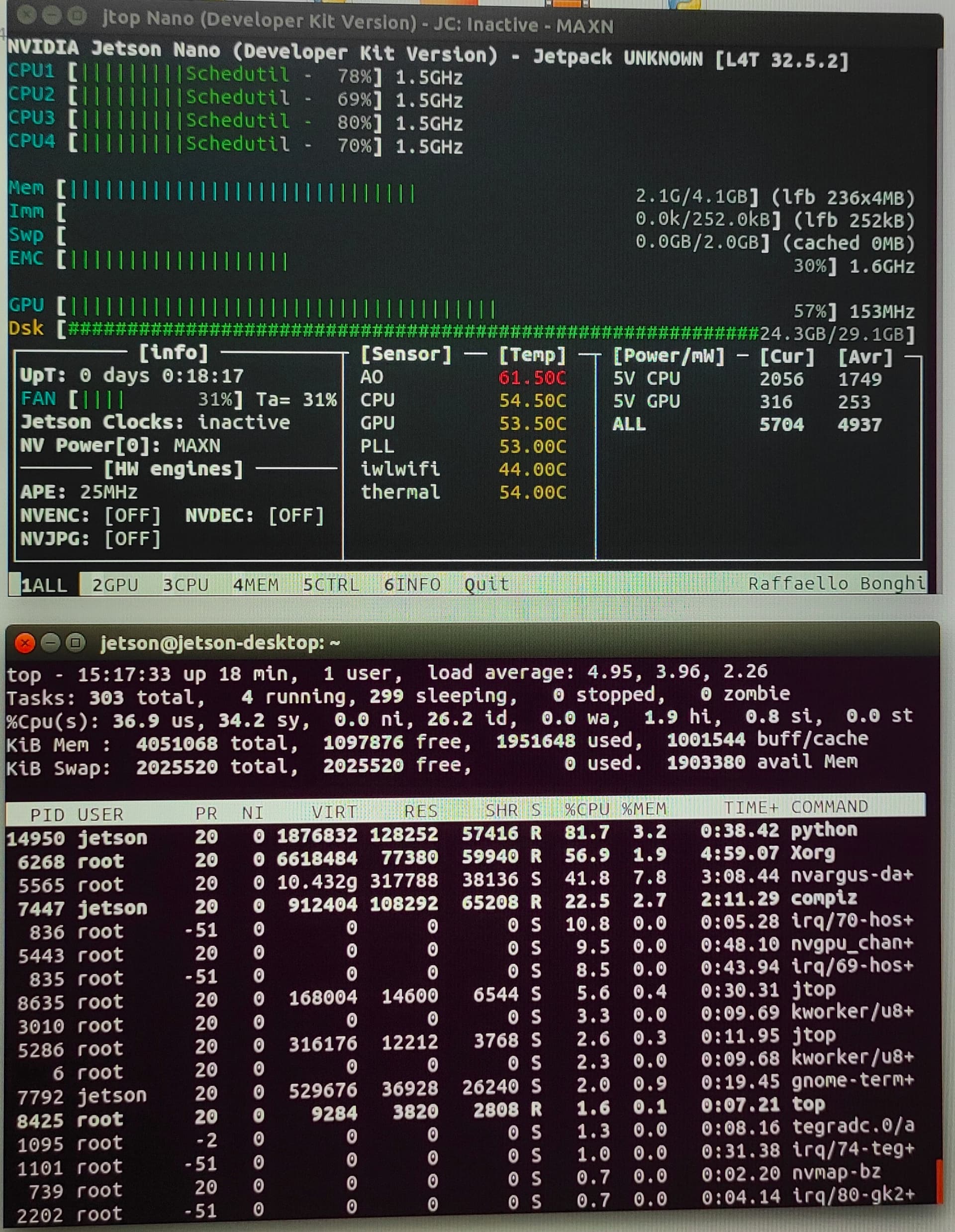

Hello, I was trying to get dual camera access on my jetson Nano B01 board. I got the access and it’s perfectly synchronized, but I got that all the 4 CPU cores works maximisely and I don’t want to push cpu cores this much heavy. So does anyone know how to offload the task from CPU to GPU.? Thanks in advance…!

The CPU usage depend on the sensor resolution and frame rate.

How do you check the CPU usage?
sudo jtop and nsight system profiler
I get below result by run your command. And top show about 26% of cpu usage of 4 cpu cores.

We are running this dual camera code in a frame sequential manner
I run two camera get about 52% + 18% +18 % CPU usage. And about 13% + 4.9% +4.7% whole system(4 cores) press shift + i to switch the Irix mode.
Irix mode on
Tasks: 314 total, 1 running, 312 sleeping, 0 stopped, 1 zombie
%Cpu(s): 13.1 us, 12.4 sy, 0.0 ni, 72.7 id, 0.0 wa, 1.0 hi, 0.8 si, 0.0 st
KiB Mem : 3921020 total, 965984 free, 1900768 used, 1054268 buff/cache
KiB Swap: 1960496 total, 1960496 free, 0 used. 1820336 avail Mem
PID USER PR NI VIRT RES SHR S %CPU %MEM TIME+ COMMAND
5415 root 20 0 10.291g 236084 37388 S 52.5 6.0 0:34.69 nvargus-daemon
8297 nvidia 20 0 9579376 58708 28452 S 18.5 1.5 0:14.23 gst-launch-1.0
8679 nvidia 20 0 9577916 57112 28516 S 18.2 1.5 0:10.20 gst-launch-1.0
Irix mode off
Tasks: 306 total, 2 running, 303 sleeping, 0 stopped, 1 zombie
%Cpu(s): 13.5 us, 12.9 sy, 0.0 ni, 71.9 id, 0.0 wa, 1.0 hi, 0.8 si, 0.0 st
KiB Mem : 3921020 total, 784084 free, 1910268 used, 1226668 buff/cache
KiB Swap: 1960496 total, 1959220 free, 1276 used. 1794140 avail Mem
5415 root 20 0 10.291g 246400 37412 S 13.1 6.3 2:34.20 nvargus-daemon
8679 nvidia 20 0 9578240 57200 28268 S 4.9 1.5 0:52.00 gst-launch-1.0
8297 nvidia 20 0 9579692 58776 28180 S 4.7 1.5 0:57.06 gst-launch-1.0
what is this irix mode in nano? will it make efficient in dual camera streaming and processings.?
It’s for multiple CPUs usage calculation.
So what should we need to do?
If you got the same result then it already the optimize.
How can we shift to Irix mode and back.
Press shift + i again
Looks like the python use much more CPU source.
The nvargus-daemon is as expect.
