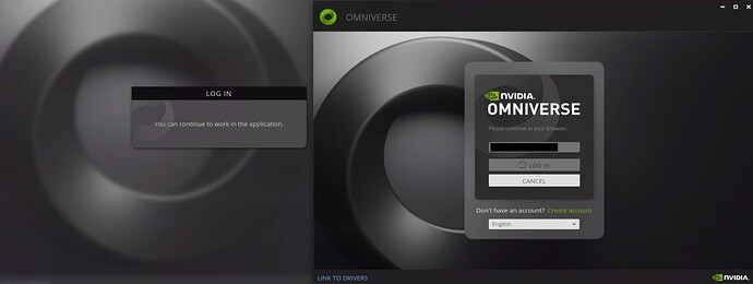

I have been unable to get the omniverse launcher to progress past a login screen despite attempts to reset password and having the login pass. Has anyone seen this before and have suggestions?
 ![2023-11-13_12-19-50](https://global.discourse-cdn.com/nvidia/original/4X/c/9/d/c9d0556e70180a021816d07c7ac4cea88265e9ae.jpeg)
I’m including the log from the app image terminal window below as well

@eking3 which browser are you using? there were reports of other users having better luck using a different browser. could give it a shot and see what happens.

Hi I’m using firefox, currently but I can try with some others instead

Thank you @Simplychenable I should’ve thought to try a different browser. After installing and restarting with Google Chrome, the normal sign on process started up and I was able to get the main gui started.
