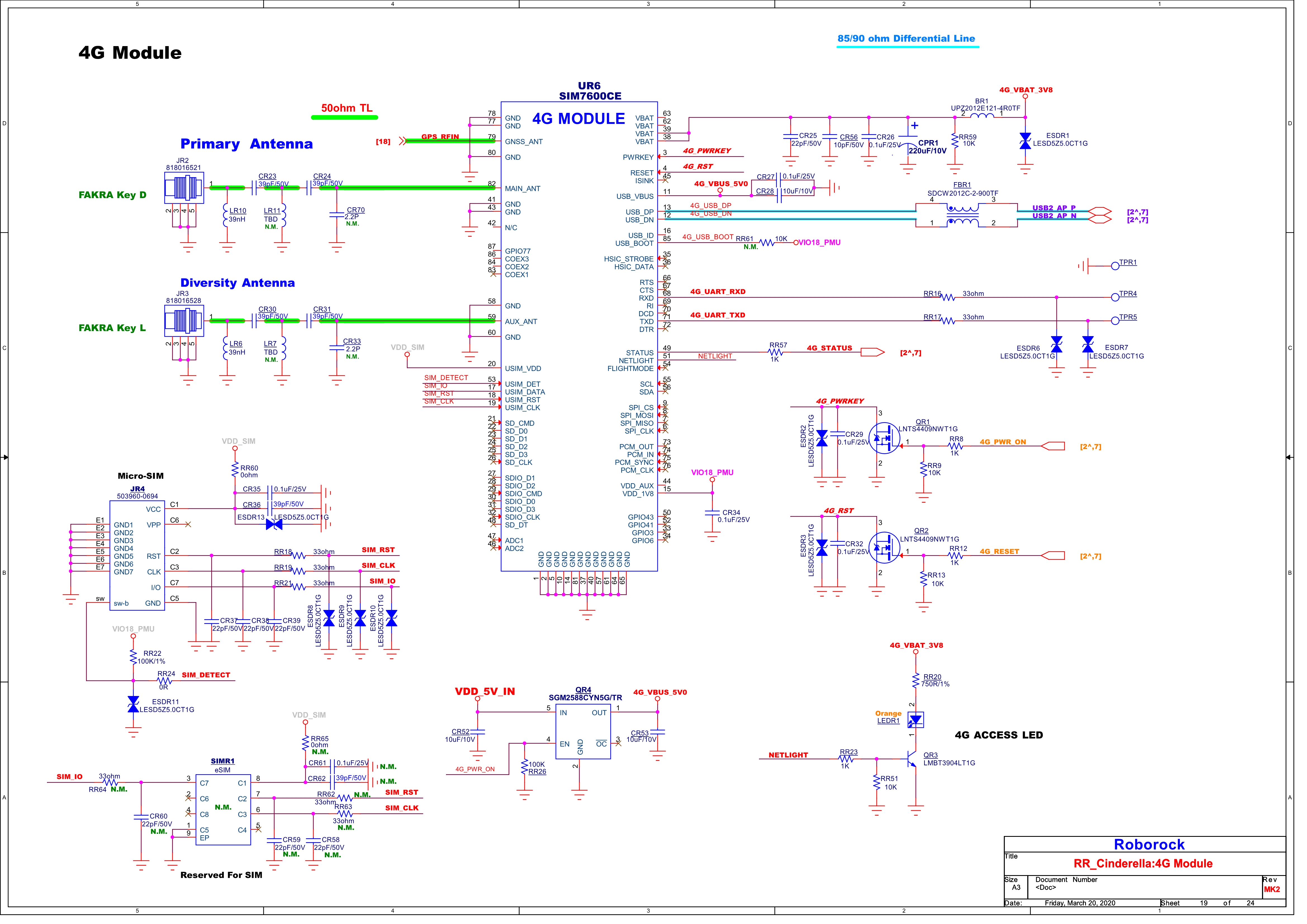

Hi，nvidia
On my own designed carrier board， the usb hub sometimes cannot be detected. the hub is RTS5411S and follow the EVB circuit design .
When the hub cannot be detected, the log is:
[1.841900] usb 1-2: device not accepting address 2, error -71
[2.381901] usb 1-2: device not accepting address 3, error -71
[3.358056] usb 1-2: device descriptor read/64, error -71
[3.590053] usb 1-2: device descriptor read/64, error -71
[3.942056] usb 1-2: device descriptor read/64, error -71
[4.174059] usb 1-2: device descriptor read/64, error -71
[4.285938] usb usb1-port2: unable to enumerate USB device
[5.005898] usb 1-2: device not accepting address 6, error -71
[5.545900] usb 1-2: device not accepting address 7, error -71
Also I try the method in
https://forums.developer.nvidia.com/t/usb-power-control/79037/6
however, it hints:
[error]:open device 0bda:5411 fail.
and lsusb result is:
roborock@jetson-nano:~$ lsusb
Bus 002 Device 001: ID 1d6b:0003 Linux Foundation 3.0 root hub
could you help to check which the problem may be?

Please share schematic of the USB port, and full _dmesg_ for reference.

Hi， DaneLLL
The Dmesg result is：

 ![061113580450_0USBSch_1](https://global.discourse-cdn.com/nvidia/original/3X/1/d/1d6d5f20765ee171fc98271c738eaa5e8c4f23d1.jpeg) ![061113580450_0USBSch_2](https://global.discourse-cdn.com/nvidia/original/3X/9/b/9b1af8431c1c47a31b5fea3d9994ca53b904ea58.jpeg) ![061113580450_0USBSch_3](https://global.discourse-cdn.com/nvidia/original/3X/8/f/8f4fc45a71fd13be47dd6c7308c05683e82e83d4.jpeg) ![061113580450_0USBSch_4](https://global.discourse-cdn.com/nvidia/original/3X/2/4/24ba1ba520d592fed1088f34464630db7779cd8b.jpeg)

Hi，DaneLLL
any update？ I found that if the problem occurs， all the USB port are fail， I think it’s the problem of the root hub
