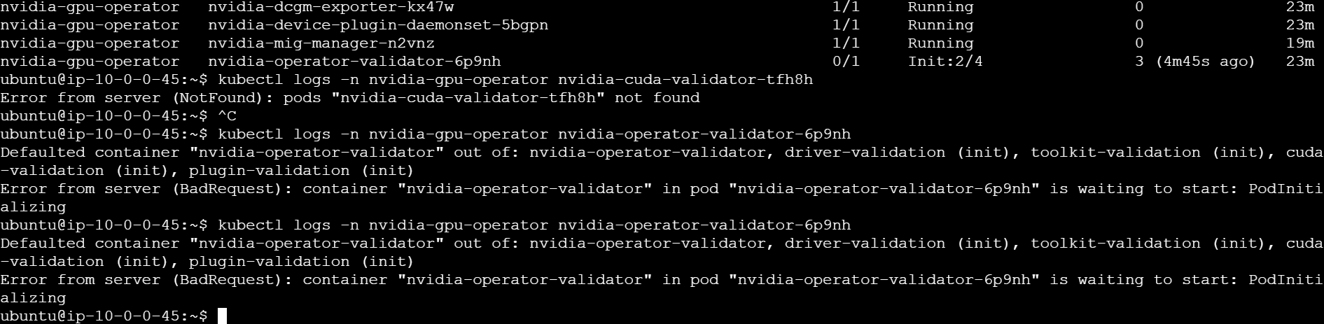

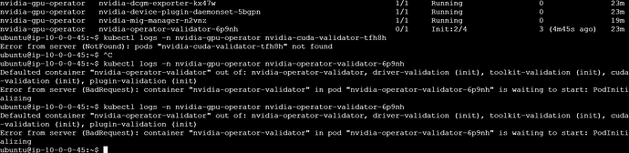

Yes, I tried to run the commands suggested by you, but unfortunately we were getting the same issue.
after checking the pods this is the issue that I was getting:
ubuntu@ip-xx-x-x-xx:~$ kubectl logs -n nvidia-gpu-operator nvidia-operator-validator-6p9nh
Defaulted container “nvidia-operator-validator” out of: nvidia-operator-validator, driver-validation (init), toolkit-validation (init), cuda-validation (init), plugin-validation (init)
Error from server (BadRequest): container “nvidia-operator-validator” in pod “nvidia-operator-validator-6p9nh” is waiting to start: PodInitializing
It seems GPU Operator deployment is having issue.
Is nvidia-operator-validator* the only pod not in running state?
This means some of the init containers are not successful.
Could you check the logs of those init containers with the following command?
kubectl logs -n nvidia-gpu-operator nvidia-operator-validator-6p9nh -c “< container name >”
e.g.
kubectl logs -n nvidia-gpu-operator nvidia-operator-validator-6p9nh -c driver-validation
