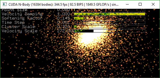

So ran nbody from the CUDA 6.5 release directory for 5 minutes and then took this screenshot of the GPU-Z output for one of the two GTX Titan-X GPUs;
[url]http://imgur.com/3GEtVLV[/url]
Did notice that the core clock started at about 1189.3 then dropped a bit as the temperature rose over 70 degrees Celsius.
Using only 38% of TDP.
very different numbers than Allanmac’s output. This is an EVGA Titan X without the ACX cooler they used for the high-clock EVGA GTX 980 SC.
Another item of interest was that when I ran one of my large brute force problems on a single Titan X and looked at that output on GPU-Z the both the core and memory clocks fluctuated quite a bit more and it showed the GPU load at 0%, which seems odd.

I think you’re looking at the wrong TITAN X since NBody might run its compute on one GPU and render on whichever GPU is connected to your monitor.
The BIPS/GFLOPS in your screenshot are 25-30% more than the GTX 980 which happens to be very close to 30721189 cores vs. 20481392 (28%)!
In my case, I have the monitor connected to a 750 Ti and NBody selects the GTX 980 as the simulation GPU.

@allanmac: I think I’ve spotted the source of the discrepancy. You probably ran the nbody bench without increasing the -nbodies argument from the default value, that why you’re getting only 75% SM utilization and much lower memory usage than I do.
My mistake in the previous post, my spreadsheet did include the correct benchmark command:
while true; do nbody -benchmark -numbodies=256000; done

I ran the 256K nbody benchmark in a tight loop and it does throttle at a peak of 103% TDP and the clock oscillates between 1392 and 1354.
NBody is an impressive abuser of the GPU! :)
The power reported by nvidia-smi seems to momentarily hit 192W (103%) but most of the time is clamped to its 185W (100%) cap.
The green regions in the “Perfcap Reason” graph indicate when the GTX 980 is power limited:
After running for 10 minutes the GPU clock still swings between 1354 and 1392.
The MEM clock and temps remain steady at 1752 and 71C.
IMHO, the “benchmark” switch is a poor choice for determining a GPU’s max sustained flops and power as 256K bodies is still too short of a duration.
Let me know if this is what you’re looking for!
