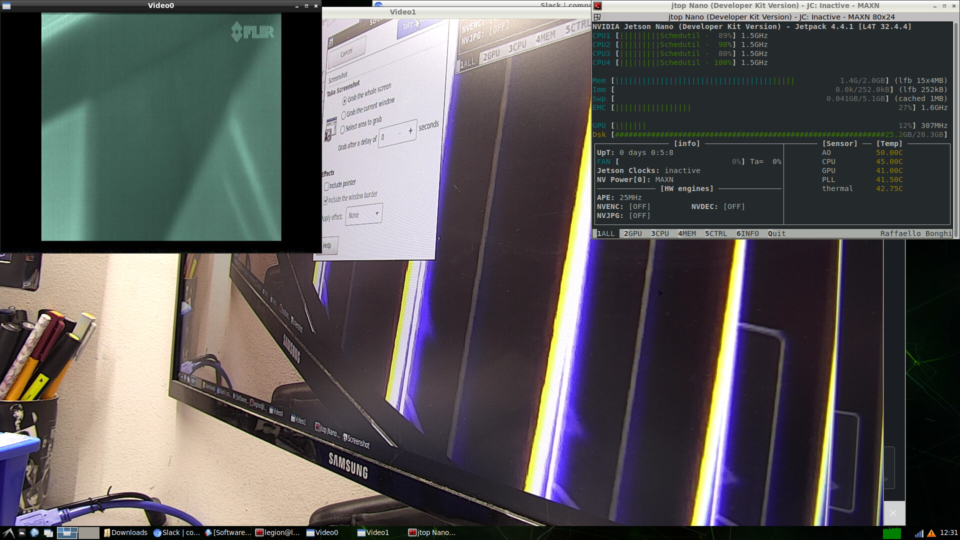

Ok, so I have two cameras connected to my Jetson Nano 2GB board :

Camera 1 :
VIDIOC_ENUM_FMT
Index : 1
Type : Video Capture
Pixel Format: 'YUYV'
Size: Discrete 1920x1080
If I open them via GStreamer :
For camera 0:
$ gst-launch-1.0 tee name=stream v4l2src device=/dev/video0 ! image/jpeg,width=1280,height=720,framerate=60/1 ! jpegparse ! jpegdec ! xvimagesink sync=false
For camera 1:
$ gst-launch-1.0 v4l2src device=\"/dev/video1\" ! xvimagesink
Both are working perfectly fine - there’s no lag
But if I open them via OpenCV (v4.5) - VideoCapture():
cv::VideoCapture cap(camId, cv::CAP_V4L);
Camera 0 works still just fine, I can even switch between settings (fourcc, resolution) with cap.set()
But Camera 1 is lagging - not like low framerate, more from time to time
Not much choice witch settings here - from what I understand I can only handle YUYV 1920x1080 if I ask about fps with .get(cv::CAP_PROP_FPS) I get expected 30 fps.
I tried cap.set(cv::CAP_PROP_BUFFERSIZE, 3) but there’s no change.
I also tried (with no success) to open it via VideoCapture GStreamer pipline
cv::VideoCapture cap("v4l2src device=/dev/video1 ! video/x-raw, format=YUY2 ! videoconvert ! video/x-raw, format=BGR ! appsink", cv::CAP_GSTREAMER);
Someone knows why there’s that lag in OpenCV, and how can I solve that? I need to show both cameras at once.
