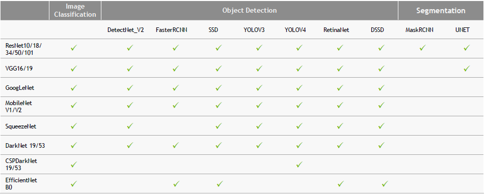

Hi @glifchitz ,
You can use YoloV4 with CSPDarkNet53 in Transfer Learning Toolkit or any of the following architectures and backbones and yield better accuracy-performance via QAT and Pruning
https://docs.nvidia.com/metropolis/TLT/tlt-user-guide/text/object_detection/yolo_v4.html
