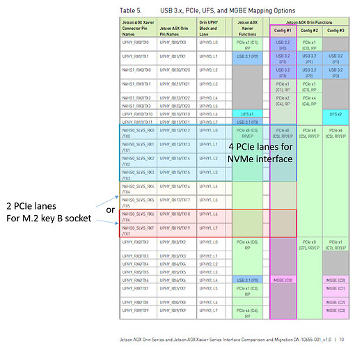

I would like to know if it possible to connect 2 devices on the same PCIe UPHY1 block
In Jetson AGX Orin functions config #1 we would like to connect:
m.2 key-m 4 PCIe lanes to UPHY1 L0-L3 to use NMVe devices
It is possible. UPHY1 config#2( nvhs-uphy-config-2) configures C5 x4(L0-L3) and C6 x4(L4-L7). Since Tegra PCIe can support lane reversal link can come up in x2 with L7 & L6. Use UPH1 L7 as logical L0 and L6 as logical L1.

You wrote that this is possible in config#2 but we want to use config#1, I assume it will be okay, am I right?
Do I have to link L7 as L0 and L6 as L1 or I can connect it as non-reversal (L7 to L1 and L6 to L0)?

I would like to know if there an option to link PCIe 4lanes AND PCIe 2lanes for both Orin AGX (config#1) AND Xavier AGX without using MUX device.
The only solution I saw is to connect them to UPHY1 and enable C5 and C6 and somhow intervening in the kernel.
We will only support these 3 configs mentioned in hardware design guide. Also, a mixing configuration is not supported. I mean you cannot pick config #1 for uphy0 block and config#2 for uphy1 block. Something like that.

I understood the configuration issue from the begining, this is not what I’m looking for.
I choose to use config#1 for my design because I need 1 MGBE interface.
I design dual design board which intend to connect to Xavier and Orin AGX modules.
I want to link UPHY1 Lanes 0-3 to m.2 key M socket for NVMe interface and UPHY1 Lanes 4-5 or Lanes 6-7 to m.2 Key B socket.
Is it possible?
