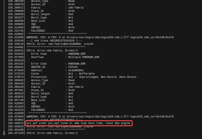

Hello. During the orin pcie C5 RP/EP virtual network test, the PCIE_RP can communicate with the PCIE_EP through the virtual network interface after the PCIE_RP reboot for the first time.
However, when only reboot the PCIE_RP for many times, the kernel of the PCIE_EP will crash occasionally.

Does it work if both RP and EP are rebooted? Since it enumerates PCIe devices in booting, it is expected to power on EP and RP at booting.
Both reboot RP and EP,the RP cannot detect the pcie EP through the lspci,The RP works properly after enumerating pcie again.
cd /sys/bus/platform/drivers/tegra194-pcie
echo 141a0000.pcie > unbind
echo 141a0000.pcie > bind
However, after normal work, I repeatedly reboot the RP,EP has the probability of kernel crash。
An issue was found, as long as “sudo ifconfig eth1 down“” disables the vnet network before restarting the RP, EP will not have an issue.
Reboot the RP may cause the EP kernel to crash when the pcie virtual network is in use.
I suspect it has something to do with the EDMA interruption, I saw it on kernel panic:
And the following patch has been applied to the RP/EP.
