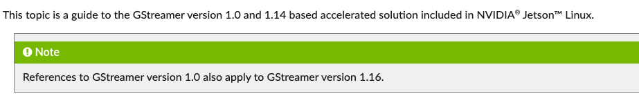

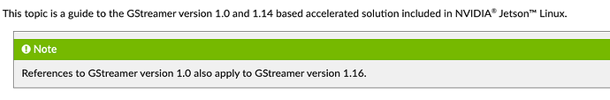

Please check the gstreamer user guide:
Accelerated GStreamer — Jetson Linux<br/>Developer Guide 34.1 documentation
En…, seems the instruction not work on my Orin kit.
