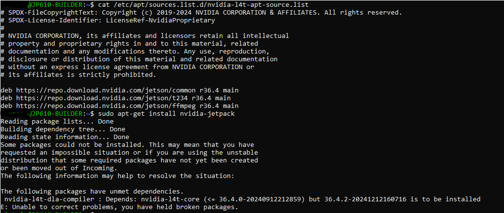

I have just flashed my Orin Nano Devkit with JP 6.1. I have run the following:
sudo apt update
sudo apt upgrade
sudo apt-get install nvidia-jetpack
The update and upgrade completed error free, but Im unable to install the nvidia-jetpack components:
Can anyone please advise.
Based on your command, you do the new point release update - referred doc
In this situation, you could try
  • reboot the device
  • execute below commands:
sudo apt update
sudo apt install nvidia-jetpack
Or reflash the device.
sudo apt --fix-broken install
