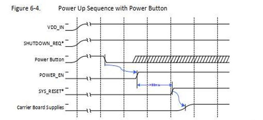

After comparing the power sequences between successful and failed boots based on Figure 6-4 (Power Up Sequence with Power Button) from the product design guide, I have identified the following:
Observation:
  • Successful Boot: All signals follow the timing diagram correctly. POWER_EN goes high, followed by SYS_RESET* asserting high after the POWER_EN goes high.
  • Failed Boot: VDD_IN and POWER_EN are present and stable, but SYS_RESET* remains pulled LOW indefinitely. Since SYS_RESET* stays low, our Custom Board Supplies never enable, and the system fails to start.
I saw there is a note says before SYS_RESET goes high, SOM will check I/O pins’ voltage. What is the I/O pins exactly? Can you give us some directions on this issue? Many thanks…

Additional observations:
  • Scenario A: When the RTC battery is disconnected from PMIC_BBAT, the SOM consistently boots successfully every time.
  • Scenario B: When an RTC battery is connected to PMIC_BBAT, the SOM encounters intermittent boot failures.
All of the input/output pins from the module to the carrier on the various interfaces. This is to avoid backfeeding power through the SoC’s pins before the on-module power up sequence completes.
Does your carrier board try to charge the backup battery? This is not supported as noted in the PMIC_BBAT description:
Note: This pin is input only and rechargeable cells or devices such as Super Caps cannot be supported.
