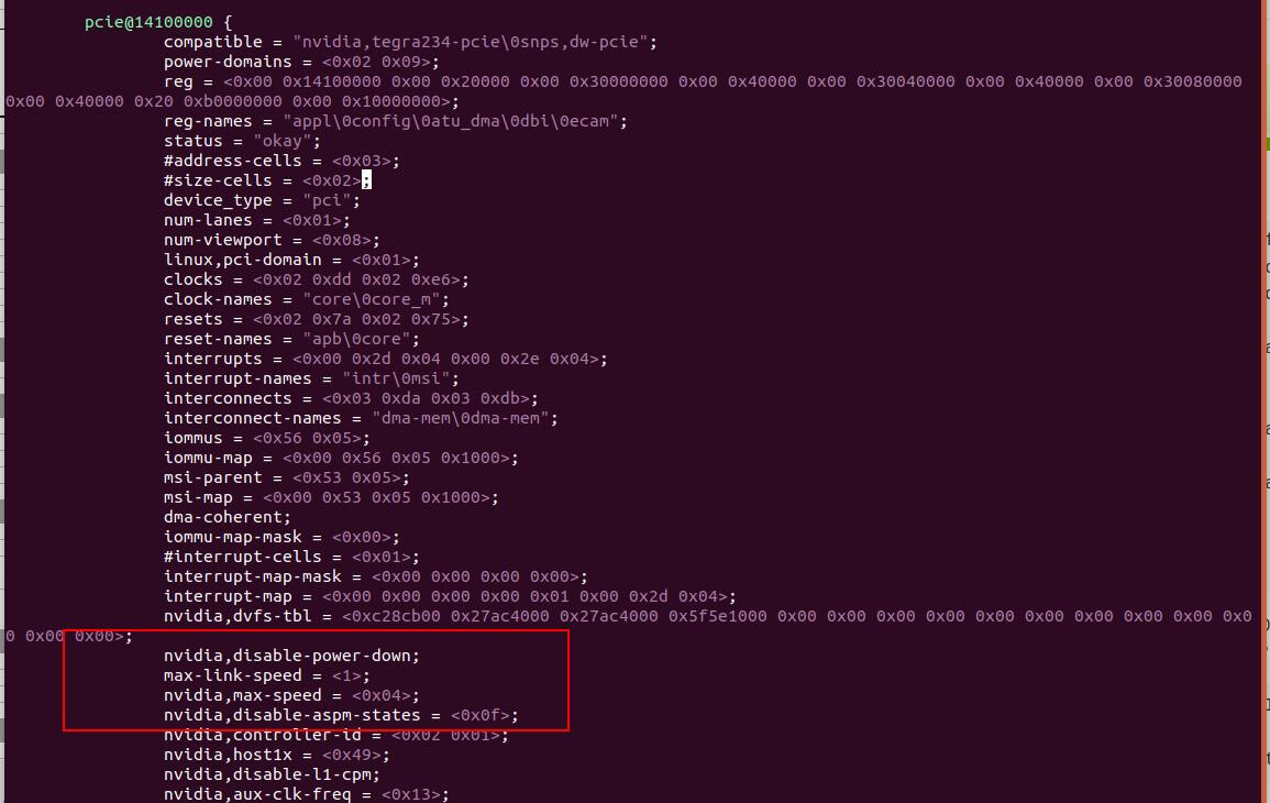

【orin nx jetpack 版本:Linux 35.6.0】Pcie bug?
sometimes boot up,pcie C1 Disappeared,but reboot Display again。
Some abnormal printing:
[ 13.114809] pci 0001:01:00.0: xHCI HW not ready after 5 sec (HC bug?) status = 0x801
[ 13.122803] pci 0001:01:00.0: quirk_usb_early_handoff+0x0/0x8b0 took 4896448 usecs
[ 13.130850] xhci_hcd 0001:01:00.0: Adding to iommu group 7
kernel.log (60.5 KB)
内核日志如附件.
lspci 却看不到pcie C1这个设备。

any update?
請問你的意思是pcie c1有時候能偵測到有時不行嗎?
是的,偶尔启动时识别不到,重启后又正常,详细可以见log
這裡最直接debug的方法就是用pcie analyzer抓LA trace.
其他方法請參考:
https://docs.nvidia.com/jetson/archives/r35.6.0/DeveloperGuide/HR/JetsonModuleAdaptationAndBringUp/JetsonAgxOrinSeries.html?highlight=debug#debug-pcie-link-up-failure
我们对pcie这个设备特性不太了解,您能从我发送的两个log中看出什么问题吗?
log上看不出什麼.基本上就是一個link有起來. 另一個沒有
這種事情很常見. 但每個用戶最後的解法都不太一樣. 跟使用的device也有相關

是设备树参数设置不当造成的吗?
基本上這一段log print已經不是我們driver的範疇了 請直接跟hub vendor討論

Dump PADCTL_PEX_CTL_PEX_L*_CLKREQ_N_0 and PADCTL_PEX_CTL_PEX_L*_RST_N_0 pinmux values and check if settings are correct.
Dump PCIE_RP_APPL_DEBUG_0 register, refer to TRM for register address of each controller. Accessing the controller’s address, which is not enabled, will cause a CBB power down error. When you share this information in NVIDIA developer forum, it will help us determine the LTSSM state.
root@iking:/home/iking/tuning/devmem2# ./devmem2 0x141000d0
/dev/mem opened.
Memory mapped at address 0xffffbb721000.
Value at address 0x141000D0 (0xffffbb7210d0): 0x0
Reduce the link speed to Gen-1 and link width to x1 using device tree properties.
