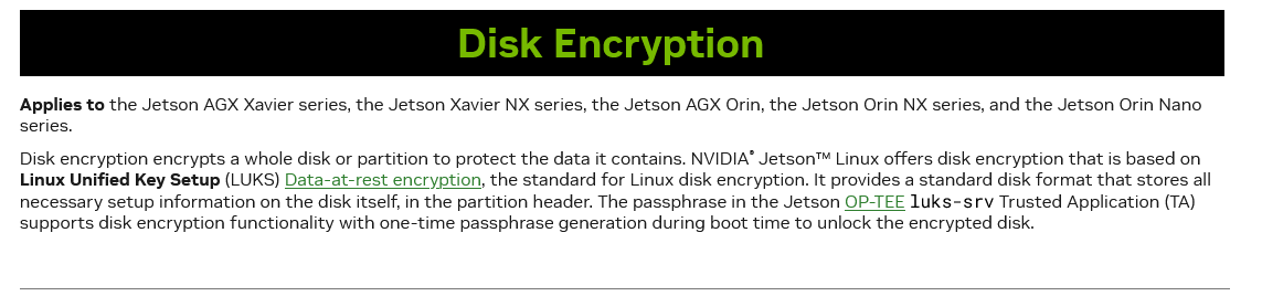

If I read the manual it tell me that the disk encyption is available for the Orin:
Can you please certify me that the disk encryption is not available for the Orin NX and nano ?
hello evilinux,
r35.4.1/ Orin NX do support with below features.
- SecureBoot
- OP-TEE
- Disk Encryption
- Secure Storage
we’ve also test and confirmed disk encryption in this forum thread, Topic 264454.
let me correct my previous comments.
