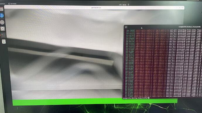

Problem Description:
(1)The first time the device was powered on, the output images were all normal, and the dmesg output was also normal.
cmd:
gst-launch-1.0 -v v4l2src device=“/dev/video0” ! video/x-raw,framerate=25/1,width=1920,height=1080,format=UYVY ! xvimagesink
(2)After closing gst-launch-1.0, and then restarting the capture process, the image became abnormal.
The “discarding” error appears in the dmesg output.
Occasionally, there may also be cases where no image is generated and it remains purely green.
Turn it off and then on again. Sometimes it will work normally again.
Basically, there are three states that randomly appear: normal/green/striped green.

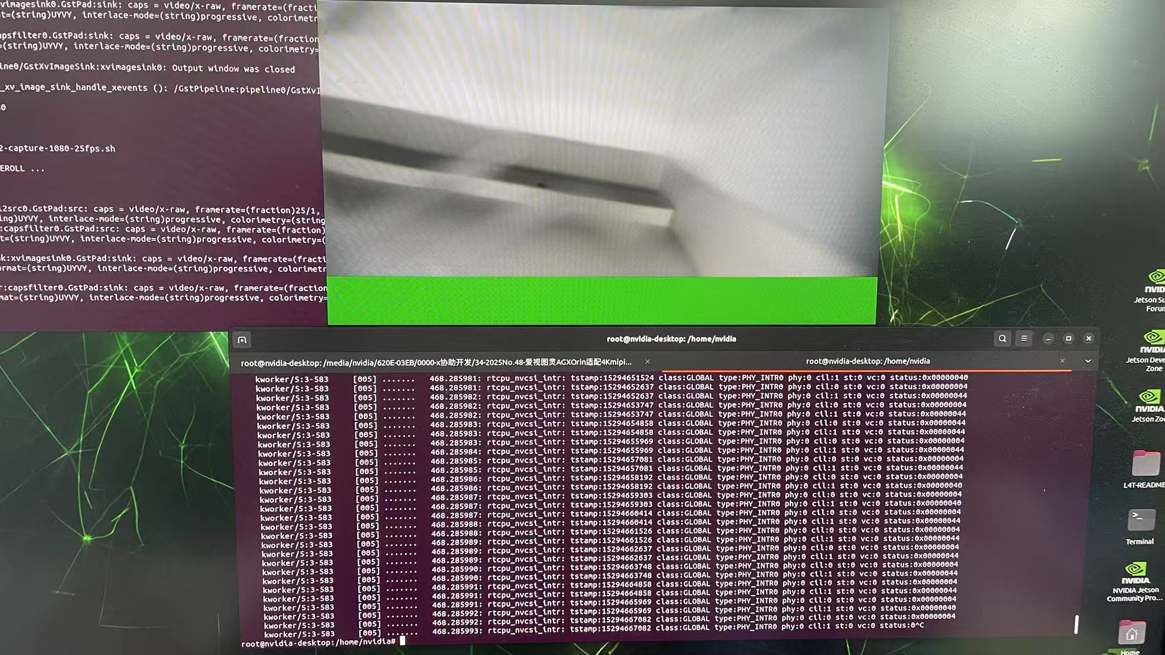

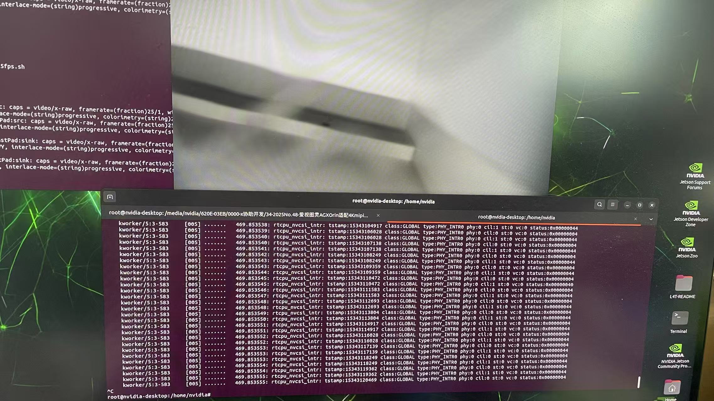

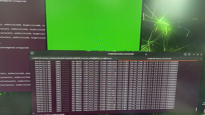

Get the trace log while failed to check.
This is the trace log corresponding to the three output image scenarios.
