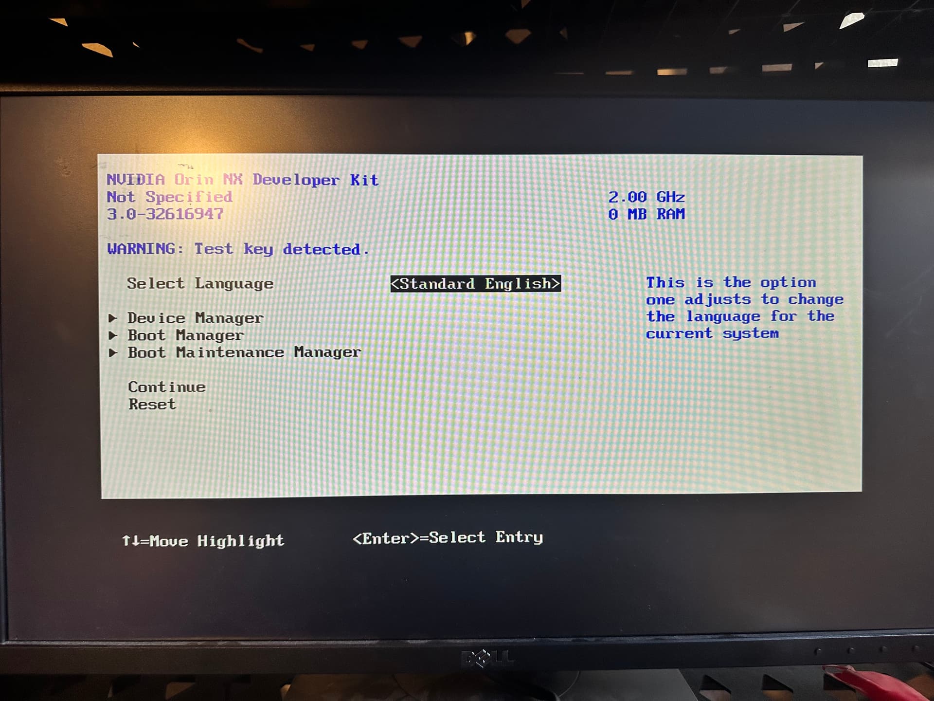

I am not able to get my kit to read any sd card ( i have tried several different ones.) In January I purchased a brand new SD card in hopes this would resolve my issue. Even in the BIOS the kit will not show the media. My nvme drive is showing. What should I try? I am following all official Nvidia directions for flashing my SD card. Attached is my BIOS version.
If the device cannot be flashed/booted, please refer to the page to get uart log from the device:
Jetson/General debug - eLinux.org
And get logs of host PC and Jetson device for reference. If you are using custom board, you can compare uart log of developer kit and custom board to get more information.
Also please check FAQs:
Jetson AGX Orin FAQ
If possible, we would suggest follow quick start in developer guide to re-flash the system:
Quick Start — NVIDIA Jetson Linux Developer Guide 1 documentation
And see if the issue still persists on a clean-flashed system.
~0409
Please provide the detail(referred link or commands)about how to flash your sd card?
