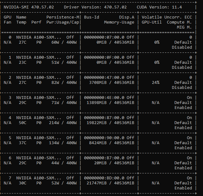

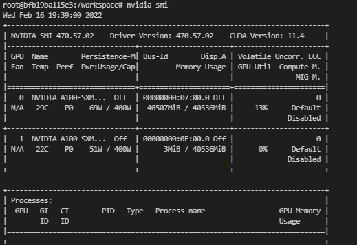

So, I got this error of OOM (out of memory), I don’t know why. And another thing, Why TLT is using all my gpu memory?
error output:
error_oom_evaluate_detectnet_v2.txt (30.8 KB)
gpu memory:
Thanks in advance.

Sometimes works but sometimes no in gpu 0 or 1. It’s so weird.
Do you think the problem is because of other people are running some processes in that gpu at the same time? But before running detectnet_v2 evaluation I always check in nvidia-smi that the usage of gpu is 0. So, it shouldnt be the problem right?
or there is a way to clean up the gpu memory to ensure that nobody is using.

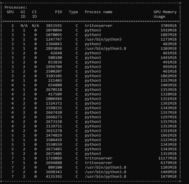

Can you open a new terminal to run nvidia-smi outside the docker?
In theory, nobody is using…
I am only using devices 0 and 1
