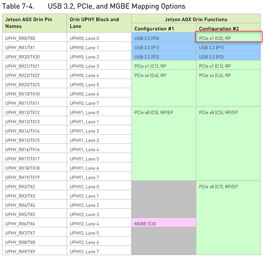

Pcie c0 has 4 links or 1 links? The pcie c6/c8/c9/c10 use which pins?
Jetson AGX Orin Platform Adaptation and Bring-Up — Jetson Linux<br/>Developer Guide 34.1 documentation says pcie c0 has 1 link:
Here is a list of the PCIe controllers that are supported by Jetson AGX Orin series and their specifications:
PCIe Controller Controller mode Supported link width Supported link speed
PCIe C0 Root port x1 Gen4
PCIe C1 Root port x1 Gen4
PCIe C4 Root port up to x4 Gen4
PCIe C5 Dual mode up to x8 Gen4
PCIe C7 Dual mode up to x8 Gen4
but int the orin trm document,it says
NOTE:
There are 3 instances for each of the “X1” registers as listed, one for each of the X1 PCIe module instances, namely
C1, C2, and C3.
There are 6 instances for each of the “X4” registers as listed, one for each of the X4 PCIe module instances, namely
C0, C4, C6, C8, C9, and C10.
According to Jetson_AGX_Orin_Series_Design_Guide, PCIe C0 is x1 link. There is no PCIe C6/C8/C9/C10 supported on Jetson_AGX_Orin module. Only one of the two supported configurations can be used in a design. Please see capture shown below for UPHY mapping of USB3.2, PCIE, and MGBE as well as Jetson AGX Orin Pin Names. A design should match or be a subset of Configuration #1 or Configuration #2.
Thanks,
“Orin Series System-on-Chip Technical Reference Manual”, this document seems to be different from what you said.We can see the figure on page 5763,it shows pcie c0 x4.This document also show us the c6/c8/c9/c10. These pcies also apear in the tegra234-soc-pcie.dtsi.For example:
/* C6 X4 */
pcie_c6_ep: pcie_ep@141c0000{
Orin SoC can be designed to virous platforms such as Automotive products , Embedded system, Jetson AGX module developr kit… etc. And there are three UPHY instances (HSIO UPHY 8-lane, NVHS UPHY 8-lane, GBE UPHY 8-lane, total 24 UPHY lane) to support various combinations for PCIe, XUSB, UFS, MGBE use cases.
In “Orin Series System-on-Chip Technical Reference Manual” you pointed out that lists all PCIe controllers in those three UPHY instances. However, since we are discussing about Jetson AGX Orin module developer kit here, that only allows two UPHY configurations as above table shown by board design.
