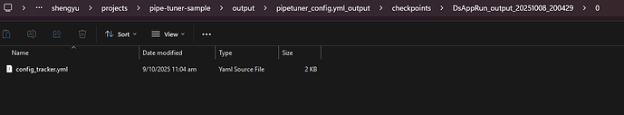

I see there is a folder “0”, can you open it?

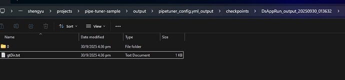

How many folders are generated under “pipe-tuner-sample/output/pipetuner_config.yml_output/checkpoints/”?
Is there any log under “pipe-tuner-sample/output”?
There is multiple DsApp run folders generated under checkpoint along with the pipetuner yml file.
Can you provide the whole folder for analysis?
checkpoints.zip (3.9 MB)
  1. From your log and files, the checkpoints configuration files are missing. The configuration files (nvinfer configuration, and deepstream-app configuration are all missing. Please check your pipetuner_config.yml file to find out whether there are file path or file name error.

The root cause is the bbo client failed to copy the configuration files to the checkpoints where the deepstream-app will work with. There are two possible reasons of the failure:
  1. There is non-standard YAML tags in your “pipetuner_config.yml” file. Since the yaml file is parsed by the python function YAML.safe_load which recognizes only standard YAML tags and cannot construct an arbitrary Python object.
  2. The path of “configs/config_PGIE/config_infer_primary.txt” is not correct.
Please check by yourself.
