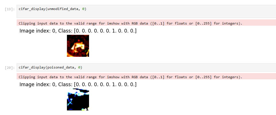

So I managed to finally pass the course, honestly the toughest course/cert I’ve ever done. But well worth it, and many many lessons learnt.
I am curious though, although this managed to pass, the image that’s supposed to look like a cat… Well isn’t very cat like. I was wondering if this is because the assessment is only checking for labels and whether it’s visually different from the original?
Hi, can you give me hint on how you solved it? my image does not seem to change. We have to use witches brew right?
Hi, just an update. after a lot and it was really a lot. I was able to pass this assessment. this was really an interesting course.
well done! so turns out the way i solved this was not the intended solution. but as is in the world of hacking, a win is a win. i blended the images together to achieve the outcome. but what one was supposed to do was to replace the datasets frogs with cats (poisoned). not concatenate, but replace. would love to know if you had a different solution - dms open.
