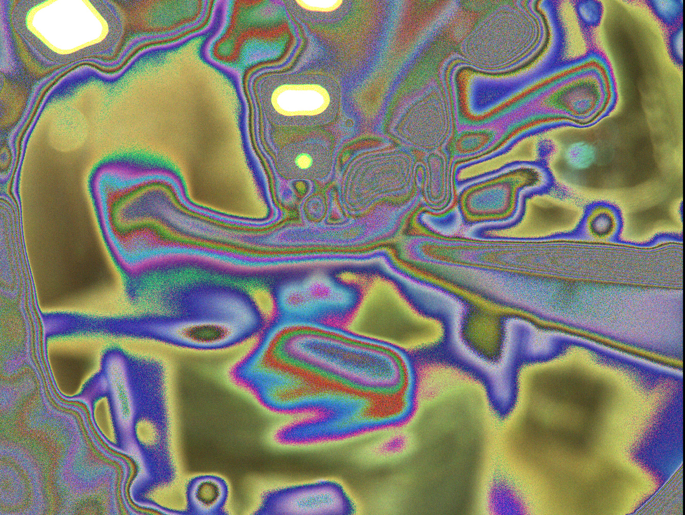

We acquire 3 camera sensor from Leopard Imaging, and they provided a reference driver for the sensor IMX230, and it works partially on TX1, kernel 3.10 and L4t 24.2.1 Nvidia devkit board, since the driver crashes sometimes when you change resolution, and it only works for the first camera, no luck with 3.
Nonetheless, we tried to port it to TX2 with no success, Leopard Imaging has no timelines for us and we seem to be stranded, and stuck with non functional camera system :( ( !@#!@##E$D! ).
We also tried to port them to another carrier board from Connected tech, it also doesnt work, but apparently because they wired the cameras to the regulators gpio expanders ( tca 9539 @74). and it seems the only problem is that the camera driver loads before the expanders are initialized, since it doesn’t recognize the gpio pins for reset nor power; which are needed to complete the camera powr on sequence, and we get this message.

Try not to access the gpio in the sensor probe function.
Hi Shane,
I tried removing any gpio related functions from the driver, and while it doesn’t complain at probing time:

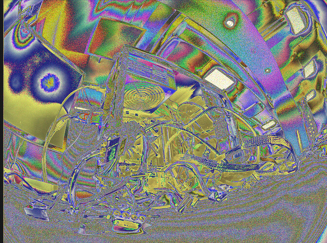

and obviously doesn’t work when i try to pull information from the camera, and it gets stuck
v4l2-ctl --device /dev/video0 --set-fmt-video=width=5344,height=4016,pixelformat=RG10 --stream-mmap --stream-to=frame0.raw --stream-count=1 --verbose
process stays there with no output whatsoever.
Please check the sensor power/reset pin is working normally by the v4l2-ctl command. Then check any timeout kernel message from the dmesg.
Hi Shane,
Yeah i manage to get cameras turning on (they respond on the i2c address when gpio is set to high), by hogging the gpios on low on the dts for the respective reset pins ( pwdn pins are not wired, thus not required ), and turning them on on the driver by setting to high the reset pin. but i am getting this now, when i try to pull an image from the camera.

[ 27.483833] imx230 30-001a: imx230_s_stream++ enable 1
[ 27.635839] imx230 30-001a: imx230_set_gain - val = -1872301073255890944
[ 27.642562] imx230 30-001a: input gain value: 73020735488
[ 27.647991] imx230 30-001a: imx230_set_gain: gain 07a3 val: 73020735488
[ 27.655222] imx230 30-001a: imx230_s_stream: error gain override
[ 27.661244] imx230 30-001a: imx230_set_frame_rate: val: -266723900232
[ 27.667691] imx230 30-001a: imx230_set_frame_length length = 0
[ 27.673532] imx230 30-001a: imx230_set_frame_length: val: 0
[ 27.680051] imx230 30-001a: imx230_s_stream: error frame length override
[ 27.686762] imx230 30-001a: imx230_set_exposure: val: 50670495149850624
[ 27.693387] imx230 30-001a: imx230_set_coarse_time
[ 27.698191] imx230 30-001a: imx230_set_coarse_time: input val: 53070561
[ 27.704826] imx230 30-001a: imx230_clamp_coarse_time: 53070561 to 4538
[ 27.711361] imx230 30-001a: imx230_set_coarse_time: set val: 12
[ 27.717912] imx230 30-001a: imx230_s_stream: error exposure override
[ 27.731701] arm-smmu 12000000.iommu: Unhandled context fault: iova=0x00000000, fsynr=0x250011, cb=19, sid=4(0x4 - VI), pgd=0, pud=0, pmd=0, pte=0
[ 27.744763] unknown mcerr fault, int_status=0x00001040, ch_int_status=0x00000200, hubc_int_status=0x00000000
[ 27.754605] unknown mcerr fault, int_status=0x00001040, ch_int_status=0x00000200, hubc_int_status=0x00000000
[ 27.764446] unknown mcerr fault, int_status=0x00001040, ch_int_status=0x00000200, hubc_int_status=0x00000000
[ 27.774273] unknown mcerr fault, int_status=0x00001040, ch_int_status=0x00000200, hubc_int_status=0x00000000
[ 27.784097] mc-err: Too many MC errors; throttling prints
[ 28.723221] tegra-vi4 15700000.vi: PXL_SOF syncpt timeout! err = -11

nvidia@tegra-ubuntu:~$ v4l2-ctl --device /dev/video0 --stream-mmap --stream-to=frame0.raw --stream-count=1 --verbose
VIDIOC_QUERYCAP: ok
VIDIOC_REQBUFS: ok
VIDIOC_QUERYBUF: ok
VIDIOC_QBUF: ok
VIDIOC_QUERYBUF: ok
VIDIOC_QBUF: ok
VIDIOC_QUERYBUF: ok
VIDIOC_QBUF: ok
VIDIOC_QUERYBUF: ok
VIDIOC_QBUF: ok
VIDIOC_STREAMON: ok
	Index    : 0
	Type     : Video Capture
	Flags    : mapped, done
	Field    : None
	Sequence : 0
	Length   : 43180032
	Bytesused: 43180032
	Timestamp: 479.580182s (Monotonic, End-of-Frame)
VIDIOC_STREAMOFF: ok
still after change image comes out corrupted, and i get this on the dmesg

Well I tried several values, and 4 seems to be cutting it, but whatever image comes out is still corrupted and some it comes with big chunks of 3FFF values, which would suggest 14 bit pixels, theoritically the driver it should be delivering RGGB10, but values like this are coming out it suggests Little Endian and 16 bit per pixel, not RGGB10:
frame0.raw
0000 0000: 22 08 72 08 02 08 22 08  32 08 F1 07 C1 07 62 08  ".r...". 2.....b.
0000 0010: 02 08 72 08 E1 07 22 08  62 08 62 08 32 08 12 08  ..r...". b.b.2...
0000 0020: 12 08 42 08 42 08 82 08  62 08 82 08 D1 07 52 08  ..B.B... b.....R.
0000 0030: 22 08 42 08 52 08 62 08  32 08 B2 08 E2 08 C2 08  ".B.R.b. 2.......
0000 0040: 12 08 A2 08 C2 08 D2 08  92 08 A2 08 52 08 C2 08  ........ ....R...
0000 0050: 92 08 52 08 C2 08 92 08  52 08 D2 08 92 08 52 09  ..R..... R.....R.
0000 0060: E2 08 B2 08 D2 08 A2 08  C2 08 22 09 F2 08 52 09  ........ .."...R.
0000 0070: 02 09 B2 08 B2 08 C2 08  B2 08 E2 08 62 08 E2 08  ........ ....b...
0000 0080: D2 08 32 09 42 08 E2 08  C2 08 02 09 42 09 42 09  ..2.B... ....B.B.
0000 0090: 12 09 C2 08 12 09 C2 08  12 09 D2 08 F2 08 A2 08  ........ ........
0000 00A0: D2 08 92 08 22 09 22 09  B2 08 F2 08 82 08 C2 08  ....".". ........
0000 00B0: F2 08 C2 08 02 09 B2 08  C2 08 D2 08 D2 08 C2 08  ........ ........
0000 00C0: D2 08 02 09 32 09 A2 08  02 09 82 08 02 09 52 09  ....2... ......R.
0000 00D0: 42 09 22 09 52 08 22 09  D2 08 02 09 B2 08 12 09  B.".R.". ........
0000 00E0: 42 09 12 09 02 09 42 09  E2 08 02 09 D2 08 62 09  B.....B. ......b.
0000 00F0: A2 08 A2 08 B2 08 C2 08  C2 08 72 08 12 09 F2 08  ........ ..r.....
0000 0100: 52 08 B2 08 A2 08 42 09  02 09 82 08 E2 08 12 09  R.....B. ........
0000 0110: C2 08 72 08 F2 08 C2 08  32 09 72 08 F2 08 72 09  ..r..... 2.r...r.
0000 0120: 72 08 22 09 B2 08 52 09  32 09 22 09 E2 08 12 09  r."...R. 2.".....
0000 0130: 32 09 02 09 A2 08 42 09  82 08 42 09 A2 08 02 09  2.....B. ..B.....
0000 0140: 42 09 22 09 A2 09 D2 08  D2 08 E2 08 02 09 32 09  B."..... ......2.
0000 0150: D2 08 F2 08 82 09 12 09  02 09 D2 08 42 09 52 09  ........ ....B.R.
0000 0160: 72 09 E2 08 32 09 52 09  22 09 42 09 82 09 82 09  r...2.R. ".B.....
0000 0170: 12 09 F2 08 22 09 62 09  52 09 42 09 02 09 22 09  ....".b. R.B...".
0000 0180: F2 08 62 09 C2 08 02 09  D2 08 32 09 02 09 42 09  ..b..... ..2...B.
0000 0190: 52 09 42 09 62 09 52 09  12 09 32 09 F2 08 32 09  R.B.b.R. ..2...2.
0000 01A0: 22 09 22 09 32 09 52 09  42 09 E2 08 82 09 32 09  ".".2.R. B.....2.
0000 01B0: 32 09 02 09 52 09 12 09  52 09 52 09 52 09 02 09  2...R... R.R.R...
0000 01C0: 22 09 32 09 E2 08 62 09  32 09 72 09 92 09 C2 08  ".2...b. 2.r.....

After playing a bit here and there, with no much success we requested the sensor datasheet information, and after checking it we confirm the number of embedded lines sent by the sensor, which fixed much of the problems, but still the image comes with tail information, apparently it is also sending information of the called “dummy pixels”, which is a 00 pattern at the end of each line, could you please point me on how to change this so that the driver ignores that at the end or beggining of each line ?
frame0.raw
0000 2870: 31 07 D1 07 B1 07 D1 07  01 07 C1 07 41 07 91 07  1....... ....A...
0000 2880: 21 07 81 07 21 07 61 07  31 07 E1 07 21 07 D1 07  !...!.a. 1...!...
0000 2890: 51 07 C1 07 61 07 B1 07  31 07 B1 07 E1 06 D1 07  Q...a... 1.......
0000 28A0: 51 07 81 07 51 07 A1 07  F1 06 01 07 01 07 41 07  Q...Q... ......A.
0000 28B0: D1 06 21 07 31 07 51 07  F1 06 C1 07 11 07 71 07  ..!.1.Q. ......q.
0000 28C0: C1 06 81 07 31 07 91 07  F1 06 81 07 E1 06 71 07  ....1... ......q.
0000 28D0: 51 07 71 07 11 07 41 07  E1 06 21 07 51 07 61 07  Q.q...A. ..!.Q.a.
0000 28E0: E1 06 41 07 01 07 01 07  F1 06 31 07 D1 06 F1 06  ..A..... ..1.....
0000 28F0: 11 07 41 07 11 07 61 07  B1 06 11 07 C1 06 F1 06  ..A...a. ........
0000 2900: A1 06 41 07 01 07 71 07  D1 06 31 07 C1 06 31 07  ..A...q. ..1...1.
0000 2910: B1 06 21 07 B1 06 F1 06  C1 06 01 07 21 07 41 07  ..!..... ....!.A.
0000 2920: 01 07 31 07 A1 06 21 07  C1 06 31 07 71 06 E1 06  ..1...!. ..1.q...
0000 2930: 71 06 F1 06 B1 06 31 07  C1 06 B1 06 81 06 31 07  q.....1. ......1.
0000 2940: 91 06 A1 06 91 06 21 07  D1 06 A1 06 91 06 11 07  ......!. ........
0000 2950: 91 06 B1 06 81 06 D1 06  71 06 A1 06 61 06 D1 06  ........ q...a...
0000 2960: 71 06 F1 06 51 06 F1 06  81 06 11 07 A1 06 B1 06  q...Q... ........
0000 2970: 41 06 C1 06 91 06 A1 06  61 06 11 07 61 06 D1 06  A....... a...a...
0000 2980: 61 06 B1 06 51 06 D1 06  01 06 91 06 11 06 C1 06  a...Q... ........
0000 2990: 11 06 A1 06 11 06 81 06  01 06 51 06 F1 05 81 06  ........ ..Q.....
0000 29A0: 51 06 21 06 21 06 71 06  01 06 A1 06 61 06 81 06  Q.!.!.q. ....a...
0000 29B0: 31 06 91 06 11 06 91 06  11 06 41 06 21 06 71 06  1....... ..A.!.q.
0000 29C0: 00 00 00 00 00 00 00 00  00 00 00 00 00 00 00 00  ........ ........
0000 29D0: 00 00 00 00 00 00 00 00  00 00 00 00 00 00 00 00  ........ ........
0000 29E0: 00 00 00 00 00 00 00 00  00 00 00 00 00 00 00 00  ........ ........
0000 29F0: 00 00 00 00 00 00 00 00  00 00 00 00 00 00 00 00  ........ ........
0000 2A00: 42 08 91 05 02 08 C1 05  F1 07 91 05 12 08 C1 05  B....... ........
@amatasan
Try to add the dummy pixels to your sensor driver. Like if your sensor driver report 1920x1080 and have 2 dummy pixels try to report 1920x1010 in you sensor driver.
@ShaneCCC
You mean adding the reported resolution on the driver’s code or in the device tree, because I tried both, and it doesn’t seem to cut it.

As you can tell the stride value doesn’t match with the stride size.
width x byte depth ( 10 bit )
5344×2 = 10688
reported one is 10752, which would be 5376 per line… which means 32 bytes more than the reported resolution.
@amatasan
Could you try report the resolution as 5360x4032 or 5408x4112.
@ShaneCCC
So I’ve tried that, and no matter where I tell the sensor to report different resolution, either kernel driver or device tree, it makes no difference I get the zeroes after each line. on the IMX230 this is on 0x29C0 = 5344x2:
frame230.raw

DMESG:
[  250.100880] imx230 32-001a: imx230_power_on: power on
[  250.666727] tegra_mipi_cal 3990000.mipical: Mipi cal timeout,val:9981, lanes:3000000
[  250.674532] tegra_mipi_cal 3990000.mipical: MIPI_CAL_CTRL                  0x04 0x2a000010
[  250.682933] tegra_mipi_cal 3990000.mipical: CIL_MIPI_CAL_STATUS            0x0c 0x00009981
[  250.691289] tegra_mipi_cal 3990000.mipical: CIL_MIPI_CAL_STATUS_2          0x10 0x00000000
[  250.699672] tegra_mipi_cal 3990000.mipical: CILA_MIPI_CAL_CONFIG           0x18 0x00000000
[  250.707982] tegra_mipi_cal 3990000.mipical: CILB_MIPI_CAL_CONFIG           0x1c 0x00000000
[  250.716334] tegra_mipi_cal 3990000.mipical: CILC_MIPI_CAL_CONFIG           0x20 0x00000000
[  250.724626] tegra_mipi_cal 3990000.mipical: CILD_MIPI_CAL_CONFIG           0x24 0x00000000
[  250.732920] tegra_mipi_cal 3990000.mipical: CILE_MIPI_CAL_CONFIG           0x28 0x00200000
[  250.741237] tegra_mipi_cal 3990000.mipical: CILF_MIPI_CAL_CONFIG           0x2c 0x00200000
[  250.749549] tegra_mipi_cal 3990000.mipical: DSIA_MIPI_CAL_CONFIG           0x3c 0x00000200
[  250.757868] tegra_mipi_cal 3990000.mipical: DSIB_MIPI_CAL_CONFIG           0x40 0x00000200
[  250.766182] tegra_mipi_cal 3990000.mipical: DSIC_MIPI_CAL_CONFIG           0x44 0x00000200
[  250.774485] tegra_mipi_cal 3990000.mipical: DSID_MIPI_CAL_CONFIG           0x48 0x00000200
[  250.782783] tegra_mipi_cal 3990000.mipical: MIPI_BIAS_PAD_CFG0             0x5c 0x00000000
[  250.791073] tegra_mipi_cal 3990000.mipical: MIPI_BIAS_PAD_CFG1             0x60 0x00000000
[  250.799358] tegra_mipi_cal 3990000.mipical: MIPI_BIAS_PAD_CFG2             0x64 0x00010010
[  250.807650] tegra_mipi_cal 3990000.mipical: DSIA_MIPI_CAL_CONFIG_2         0x68 0x00000002
[  250.815965] tegra_mipi_cal 3990000.mipical: DSIB_MIPI_CAL_CONFIG_2         0x6c 0x00000002
[  250.824250] tegra_mipi_cal 3990000.mipical: DSIC_MIPI_CAL_CONFIG_2         0x74 0x00000002
[  250.832547] tegra_mipi_cal 3990000.mipical: DSID_MIPI_CAL_CONFIG_2         0x78 0x00000002
[  250.840866] imx230 32-001a: imx230_s_stream++ enable 1
[  250.906170] imx230 32-001a: imx230_set_gain - val = 4194304
[  250.911789] imx230 32-001a: imx230_set_gain: gain 0000 val: 256
[  250.918481] imx230 32-001a: imx230_set_frame_rate: val: 251658240
[  250.924602] imx230 32-001a: imx230_set_frame_length length = 1652
[  250.930744] imx230 32-001a: imx230_set_frame_length: val: 1652
[  250.937581] imx230 32-001a: imx230_set_exposure: val: 125, line length: 6024, FPSF: 4194304,coarse time: 2
[  250.947279] imx230 32-001a: imx230_set_coarse_time
[  250.952105] imx230 32-001a: imx230_set_coarse_time: input val: 2
[  250.958140] imx230 32-001a: imx230_set_coarse_time: set val: 4548
[  251.236891] tegra-vi4 15700000.vi: Status:  5 channel:00 frame:0007
[  251.243189] tegra-vi4 15700000.vi:          timestamp sof 261366185664 eof 261366299808 data 0x00000001
[  251.252606] tegra-vi4 15700000.vi:          capture_id 13 stream  4 vchan  0
[  251.259712] imx230 32-001a: imx230_s_stream++ enable 0
[  251.306934] imx230 32-001a: imx230_power_off: power off
Moreover, we got an IMX377 and porting the driver to TX2, L4T 28.1, the results seem to be the same, but in this case the zeroes start on 0x2010 = 4104*2.

So it leads me to think that the issue is not on the drivers, nor any of the values reported nor on the driver or device tree. So I hope you help me get rid of this pesky zeroes.

So After playing a bit also with the IMX377 I managed to get the right side full of zeroes out of the image, but now apparently I am getting a left portion of the image on a dark colour, which impedes proper colour processing. I’ve also tested other driver modes, and even cropping, but whatever i can do with the driver cannot get rid of the blank areas, so I assume there must be somewhere else on the CSI/MIPI that is passing the whole image w blanks and ignored areas, and the driver doesn’t know how to handle it, if you don’t match the desired resolution + blanks, which in the case of the IMX377 is 4096x3046, which gave the attached images.
On the IMX377 there are 48 pixels on the left always present, as per defined on their specs, whereas on the IMX230 there is not, but there is always zeroes blanking at the end, which makes sense, my point is, where can i tell the driver to ignore that part of the image, or is it something introduced on recent patches, changes ? and perhaps it works for certain sensors, but not for all of them, which ironically everyone seems to have troubles with. on the TX2, L4T 28.1.
Updates:
After playing a bit also, with what was suggested here: https://devtalk.nvidia.com/default/topic/1021058/jetson-tx2/-dev-video0-not-populated-in-28-1-with-yuv-camera/
,here:
https://devtalk.nvidia.com/default/topic/1016796/jetson-tx2/porting-ar0135-ds90ub964-driver-to-jetson-tx2-chansel-fault-/1
and here:
https://devtalk.nvidia.com/default/topic/1007058/jetson-tx2/porting-tx1-camera-driver-to-kernel-4-4-15-pxl_sof-syncpt-timeout/3
changing this values
#define T18X_BYPASS_LP_SEQ          (0x1 << 7)
#define DEFAULT_THS_SETTLE                  (0x14 << 0)
I managed to get buffers from the cameras with: v4l2-ctl --device /dev/video2 --set-ctrl bypass_mode=0 --stream-mmap --stream-to=frame230-2.raw --stream-count=1 --verbose
Although I still get the black bars ( either left or right side,depending on the sensor ), now I’ve only get this on dmesg, which relates with pretty much all the same problems other people has reported on the TX2, and there seems to be no solution yet.
