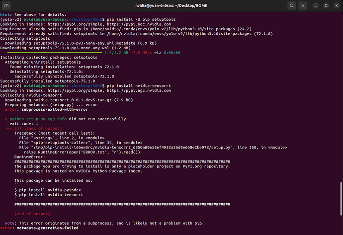

I currently have installed jetpack6 on my jetson nano. I have tensorrt 8.6.2.3 installed but not tensorrt-libs and tensorrt-bindings (8.6.2.3). I believe I need these packages to build and execute engine files. I wanted to ask if there is any pip support to download these packages, and if not, if there is any other method to do so.
I appreciate your time and help with this.
Thank you.

TensorRT python library should be installed from JetPack by default.
Please check if you have the `nvidia-tensorrt` meta package installed.

If not, please install it with `sudo apt install nvidia-tensorrt`.

### Author: ![rjayanth](https://developer.download.nvidia.com/images/forums/profile-default-devtalk-84.png) [@rjayanth](https://forums.developer.nvidia.com/u/rjayanth)
#### Post date: [September 18, 2024, 1:21pm UTC](https://forums.developer.nvidia.com/t/possibility-of-pip-installing-tensorrt-libs-and-tensorrt-bindings-8-6-2-3/306966/4 "2024-09-18T13:21:25Z")
</div>
Hi AastaLLL,
Thanks so much for your response.
I tried pip installing nvidia-tensorrt but got this error -
 ![image](https://global.discourse-cdn.com/nvidia/original/4X/3/1/7/31741acad6346a03c72423af05176d3a837d7261.png)

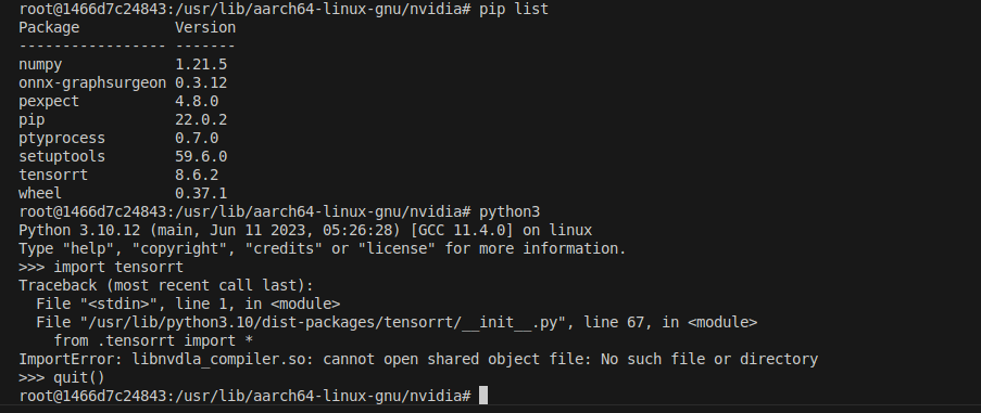

Additionally, can you check pip list in the same environment and check if you have tensorrt-libs and tensorrt-bindings installed? I believe these missing packages are the reason I cannot import tensorrt.
 ![image](https://global.discourse-cdn.com/nvidia/original/4X/2/4/3/243b49c5393bfe71b1db826e14928ab0f336e9cf.png)
Appreciate your guidance here.

Please try to install the nvidia-l4t-dla-compiler package from the below link to fix the issue:
[https://repo.download.nvidia.com/jetson](https://repo.download.nvidia.com/jetson)
