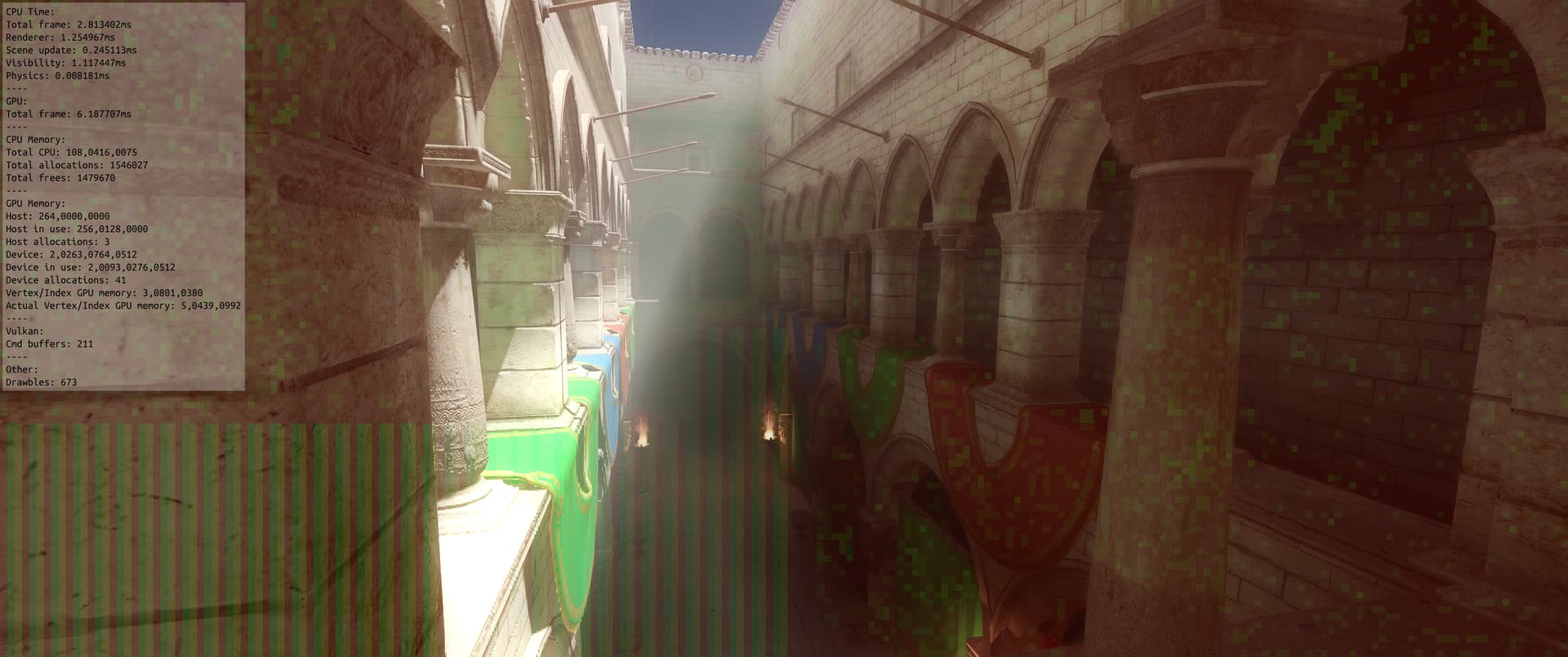

This is a somewhat complex scenario so I’ll try to describe it the best I can.
I have a frame with multiple render passes. 3 of those passes use VRS (aka KHR_fragment_shading_rate) and more precisely they are using shading rate attachments. So the frame looks somewhat like this:
- Random work
- Pass A (Uses shading rate attachment #1)
- Random work
- Pass B (Uses shading rate attachment #2)
- Random work
- Pass C (Uses shading rate attachment #1 again)
- Random work
What I observe is that Pass C uses a shading rate attachment that is a combination of attachment #1 and #2. In the image above the gl_ShadingRateEXT is used to visualize the rate picked up by Pass C. The shading rate is the expected except of the bottom left quarter of the screen that has a stripe pattern. This stripe pattern is the shading rate of the attachment #2.
Some notes:
- Validation is clean
- The attachment #2 is 1/4 of the resolution of #1 (that’s why only one quarter of the screen is wrong)
- Using nsight confirms that the attachment #1 and #2 have the correct values. Also pass C is using the correct attachment
- Adding an execution barrier (ALL_COMMANDS to ALL_COMMANDS) before C doesn’t help. But if in this barrier there is a VkMemoryBarrier with src and dst access masks to VK_ACCESS_FLAG_BITS_MAX_ENUM then the issue goes away. This most likely means a cache related problem
Let’s go into more detail on how the frame looks like then (I’ll omit the random work that happens in between):
- Pipeline barrier that transitions #1 from compute dispatch write to VRS attachment read (#1 is populated in the prev frame)
- Pipeline barrier that transitions #2 from undefined to storage image write
- Compute dispatch that populates #2
- Pipeline barrier that transitions #2 from storage image write to VRS attachment read
- Pipeline barrier that transitions #1 from VRS attachment read to storage image write
- Compute dispatch that populates #1
The barriers appear correct to me. With all the correct execution units and memory accesses. But maybe I’m wrong.
