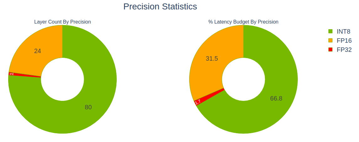

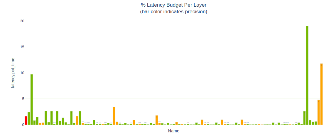

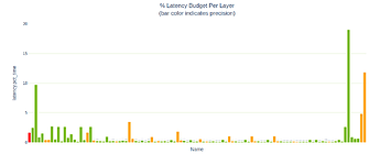

A) With constraints:
  • As you can see in the provided script
    run_quantization.zip (5.8 KB)
    , here is the list of layers I was forced to set the data type to HALF in order to avoid error Error Code 10: Internal Error (Could not find any implementation for node ...:
    • “/Resize_1”,
    • “/backbone/semantic/stage1/pool/MaxPool”
    • “/backbone/semantic/stage2/0/dwconv/0/conv/Conv”
    • “/backbone/bga/detail_down/1/AveragePool”
    • “/backbone/semantic/stage2/1/dwconv/0/conv/Conv”
    • “/backbone/semantic/stage2/1/dwconv/0/activate/Relu”
    • “/backbone/semantic/stage3/0/dwconv/0/conv/Conv”
    • “/backbone/semantic/stage3/1/dwconv/0/conv/Conv”
    • “/backbone/semantic/stage3/1/dwconv/0/activate/Relu”
    • “/backbone/semantic/stage4/0/dwconv/0/conv/Conv”
    • “/backbone/semantic/stage4/1/dwconv/0/conv/Conv”
    • “/backbone/semantic/stage4/1/dwconv/0/activate/Relu”
    • “/backbone/semantic/stage4/2/dwconv/0/conv/Conv”
    • “/backbone/semantic/stage4/2/dwconv/0/activate/Relu”
    • “/backbone/semantic/stage4/3/dwconv/0/conv/Conv”
    • “/backbone/semantic/stage4/3/dwconv/0/activate/Relu”
    • “/backbone/semantic/stage4_CEBlock/gap/0/GlobalAveragePool”

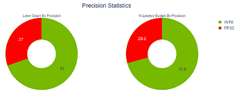

  • Precision statistics: ~ 3/4 INT8, ~ 1/4 FP16, 1 layer in FP32.
  • Complete trex report here:
    sima_simplified_with_constraints.engine.zip (3.3 MB)

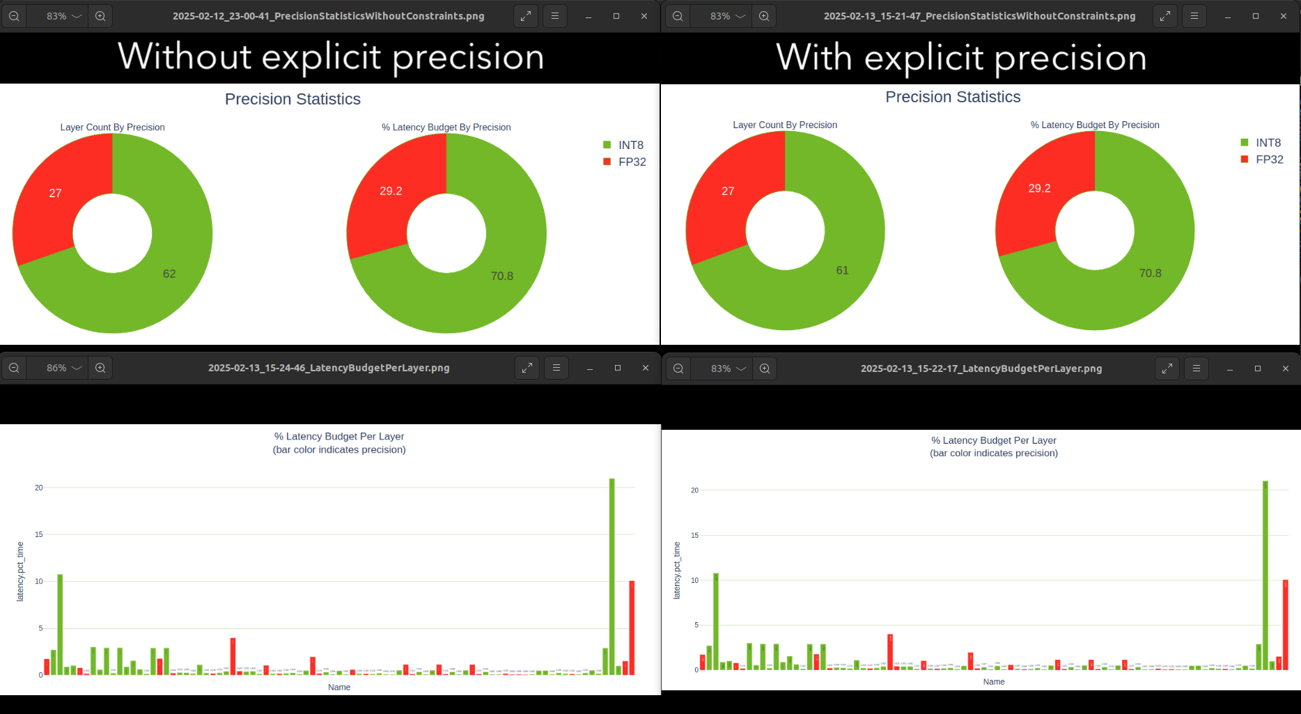

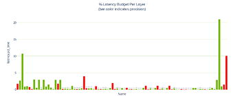

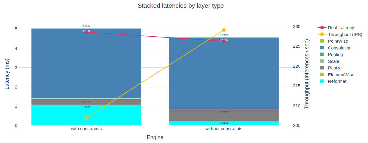

B) Without constraints:
In both cases, I used the command python run_quantization.py --int8 --verbose=DEBUG --calibration-data=/path/to/cityscapes/calibration/dataset/ --calibration-cache=cityscapes_calib.cache --explicit-batch -m /model/bisenetv2_simplified.onnx.
Comparison of both engine models realized with trex script called “compare_engines.ipynb”:
Conclusion:
  • The data type of layer “/backbone/bga/Concat_output_0” has to be set to INT32 in any case. Otherwise the script can’t continue building the engine.

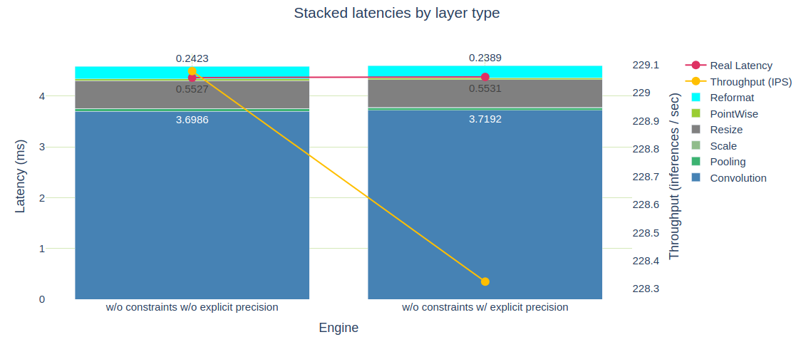

  • Letting TensorRT choose the data type of layers doesn’t allow to get a complete INT8 quantization. Forcing data types to HALF for some layers obviously doesn’t contribute to complete quantization either, but at least we see that using contraints we tend to slightly increase the number of INT8 layers.
  • Even if with constraints we have more INT8 layers, the overall latency of the engine is greater than the one of the engine without constraints. Also, when constraining the data types, more “Reformat” layers appear. This contributes to the greater overall latency.

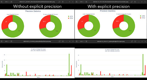

As you recommended since implicit quantization is deprecated, I finally also tried explicit quantization by keeping the same script but changing the command by using --explicit-precision flag (since I think it is the only way to do explicit quantization without changing my current script). The command I hence used here was python run_quantization.py --int8 --verbose=DEBUG --calibration-data=/path/to/cityscapes/calibration/dataset/ --calibration-cache=cityscapes_calib.cache --explicit-batch --explicit-precision -m /model/bisenetv2_simplified.onnx.
I tested this only in the case of TRT 8.5.2 and no type constraints. However, I noticed I also had to set layer “/backbone/bga/Concat_output_0” to INT32. This seems to be always necessary in order to avoid following issue:
[TRT] [E] 3: /backbone/bga/Concat_output_0: cannot use precision Int8 with weights of type Int32
[TRT] [E] 4: [network.cpp::validate::3015] Error Code 4: Internal Error (Layer /backbone/bga/Concat_output_0 failed validation)
This way, I could generate an engine but observed there is no difference between the engine built with and without flag --explicit-precision:
Conclusion: In case of TRT 10.3.0, using flag --explicit-precision doesn’t work since EXPLICIT_PRECISION is deprecated. In fact, TensorRT now automatically infers precision based on the provided calibration scales and user-defined precision constraints. Alternatively, I tried to do explicit quantization with TRT 10.3.0 using “explicit quantization” mode by specifying scales for all tensors in the network. This unfornately didn’t help to generate an engine model.

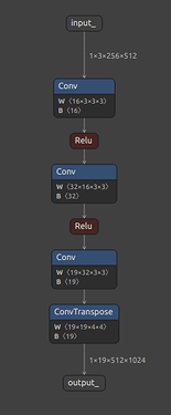

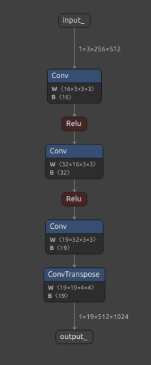

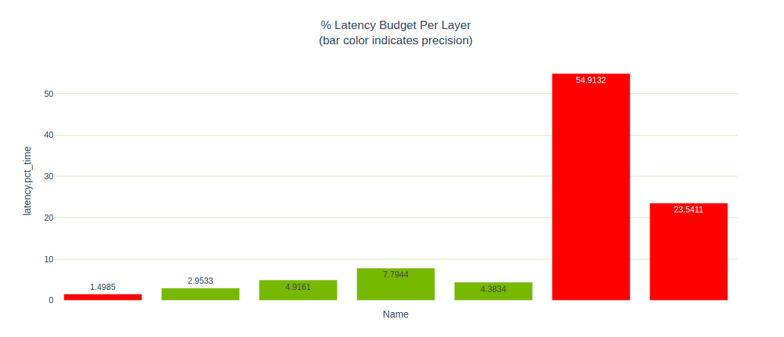

I used the exact same script and procedure for trying to quantize a much smaller and simpler model that I called “TinySegNet”. The purpose was here to see if I could at least fully quantize a basic model. This simplistic model is not designed for performance and only contains 3 convolutional layers and 1 upsampling layer at the end:
Unfortunately, it seems that the full INT8-quantization is apparently not possible here either:
Now, I would like to move away from the BiSeNet V2 model and I am wondering if, by any chance, you could provide me with a tiny semantic segmentation model where you can prove that full INT8-quantization with TensorRT is effectively possible. Based on this example where PTQ works, I could visualize layer precision distribution with trex and build upon that for testing and adapting more complex models. Would it be possible to share such a working example with me (ONNX + method)?
