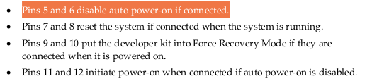

I know it’s been already discussed, but I really find it inconvenient and strange powering on just by plugging the cord into the board.
I want to have a normal power button. I would appreciate a step-by-step instruction.
Do you have a Jetson Xavier NX devkit?
Then refer following:
  • connect PIN 5 and 6 of J14 header
  • then, PIN 11 and 12 would work as a power button.
Yes as MtHiker’s comment. You can read the user guide first.
