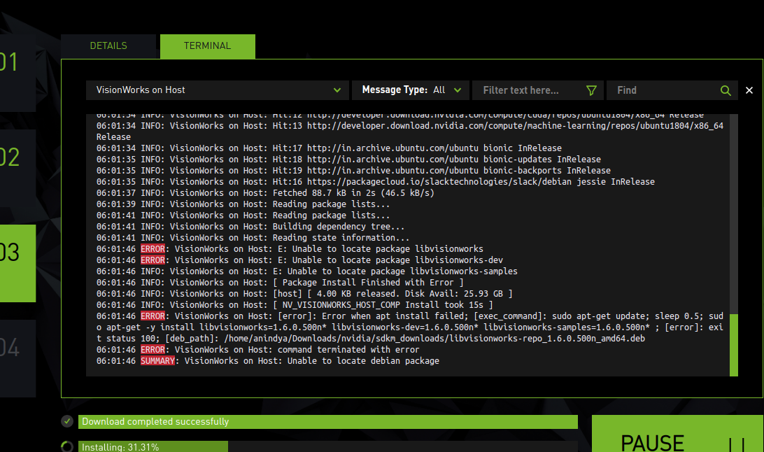

Thank you for the responses. I tried method 1 and things started to work. However, there were a lot of failure installations of various components such as Vision works, NVIDIA Container Runtime, Deepstream etc. One of the typical errors is attached. Can I install them separately once the OS is loaded at least?
Installing sdk component and flashing board could be done separately.
I think this issue only focuses on the flash process. Could you confirm if the board is able to go through the flash process first?
Please note that you can use flash.sh script instead of sdkmanager to save your time if we only want to test the flash.
