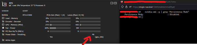

Hello everyone.
I recently built an Unraid home server and purchased an Nvidia RTX A1000 8GB for it.
The graphics card seems to successfully switch to persistence mode, but it only reaches a maximum of P8 status. What do I need to do to achieve P12?

I have never seen a card use P12, lowest I’ve seen is P8, but maybe the A1000 is different.

Perhaps try disabling Persistence. My antiquated card is idling at P12 with persistence off:

Yeah, persistent seems to make the card go into a higher p-state, at least that’s how i understood it from the post I linked. I think… ?
Besides, your card got a 50W cap so it’s not going to use more than 50W.
Tbh I think P8 is the lowest your card can do.
I tried that, but it seems like there is no difference. The GPU goes normally from P0 to P8 after disabling persistance mode…

I think the Nvidia documentation is slightly misleading, they might have removed P-states lower than P8 on newer cards?
Your card doesn’t seem to report how much wattage it uses in P8 so it’s obviously impossible to know how much it draws.
My RTX 4070 reports it uses 12W in P8 state.
You’re starring into the abyss. GPUs can have whatever PStates it was programmed to have. That PState level meaning is old and irrelevant for modern GPUs.
What matters is whether GPU/Memory clocks are at the lowest frequency and your PCIe generation is at 1.
In Unraid the PCIe Generation switches to 1 in idle. If the GPU is in use, it goes up to Gen 4.
