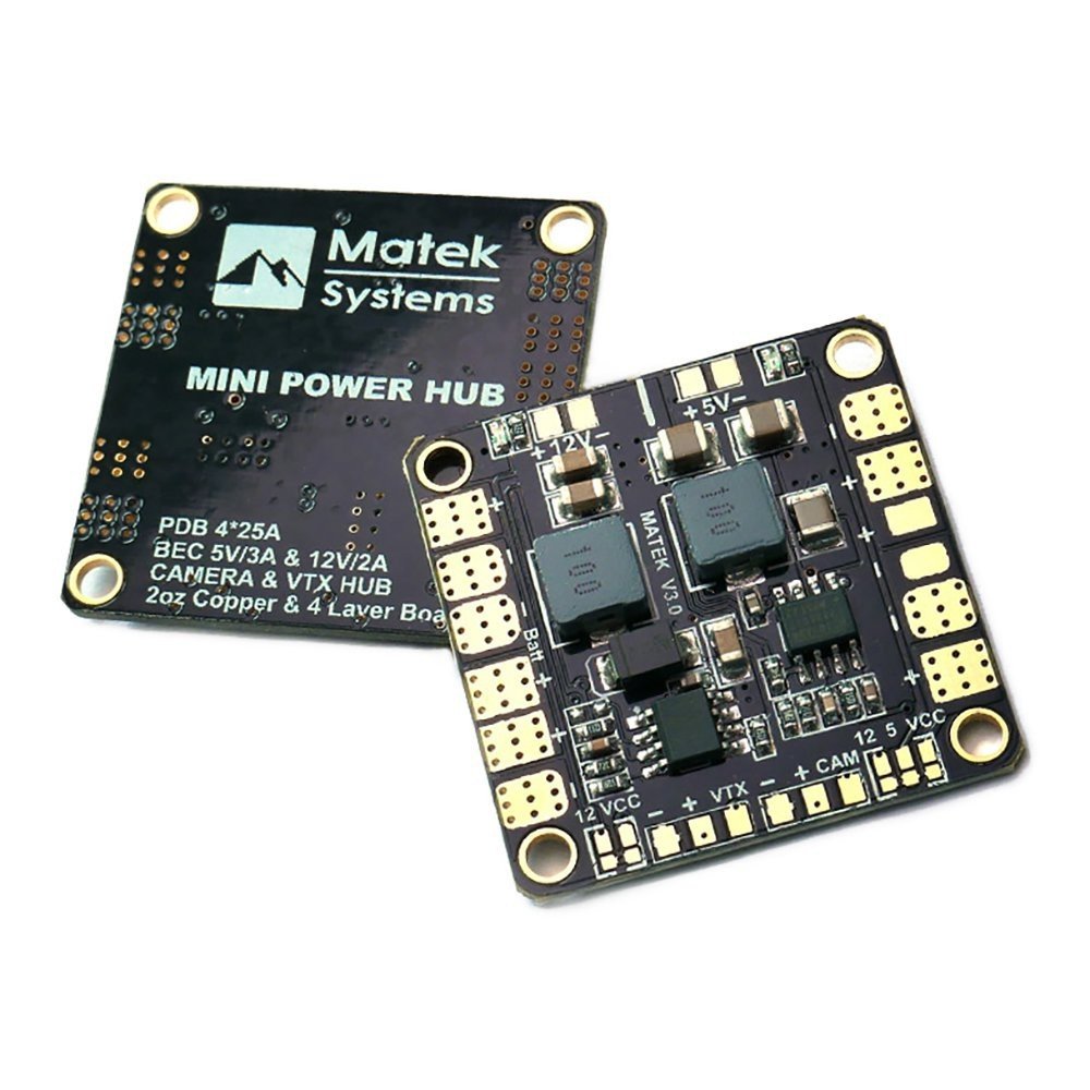

I’m not sure what happens if you give overvoltage, I’m giving voltage from Matek’s power card directly now. It gives overcurrent warning, but I dont care it, No damage given yet.
