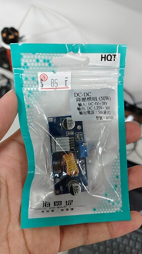

I am developing an autonomous drone with an onboard Jetson Orin Nano Devkit 8GB.
I am now trying to safely power on the Jetson using XL4015 buck converter which bucks LiPo battery’s 24V to 19.1V.
When I tested the buck converter, the jetson turns on like normal and from the software side of things it looks all good.
However there are some symptoms that I fear could shorten the Jetson’s lifespan, which are:
  • powering jetson using buck converter causes the jetson to generate some weird audio noises, I’ve confirmed this only occurs when using buck as power source by comparing it with using 19V power adaptor, where no weird audio noise is generated. I also manually stopped the fan with my finger but the noise is still significantly audible. What could be the cause of this and is this unhealthy for the jetson?
  • I noticed significant difference in the stability of the dc signal outputted by the buck converter vs adaptor when running jetson. Is it fine to run Jetson with a DC voltage which has a slightly fluctuating signal? (I provided some videos for comparison between buck vs adaptor’s DC signal, yellow line is adaptor’s signal, blue line is buck’s signal)
- voltage output of buck converter dropping from 19,1V when not powering jetson to 18.78V when powering jetson (I know this drop is normal, but is this an optimal operating voltage range?)

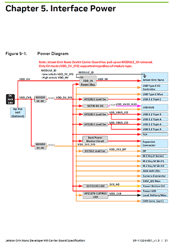

the frequency of the fluctuation/ripple of buck converter output is measured at 12.3849kHz, whereas for the output of the adaptor has <20Hz ripple. I have not tried to find the magnitude.
Does that information help in determining wether the buck’s output is safe to use or nor?
Refer to the Jetson Orin Nano Developer Kit Carrier Board Specification https://developer.nvidia.com/downloads/assets/embedded/secure/jetson/orin_nano/docs/jetson_orin_nano_devkit_carrier_board_specification_sp.pdf
See the Note about only 5V mode is supported regardless of module type.
9V to 20V is the operating voltage range for the Orin nano DevKit. Use lower operating voltage as appropriate for your use case. If the input voltage is fluctuating a lot then maybe your chosen battery/power supply is not able to provide the peak current needed by the DevKit/Jetson module. What is the current/voltage/power rating of the battery/power supply used?
