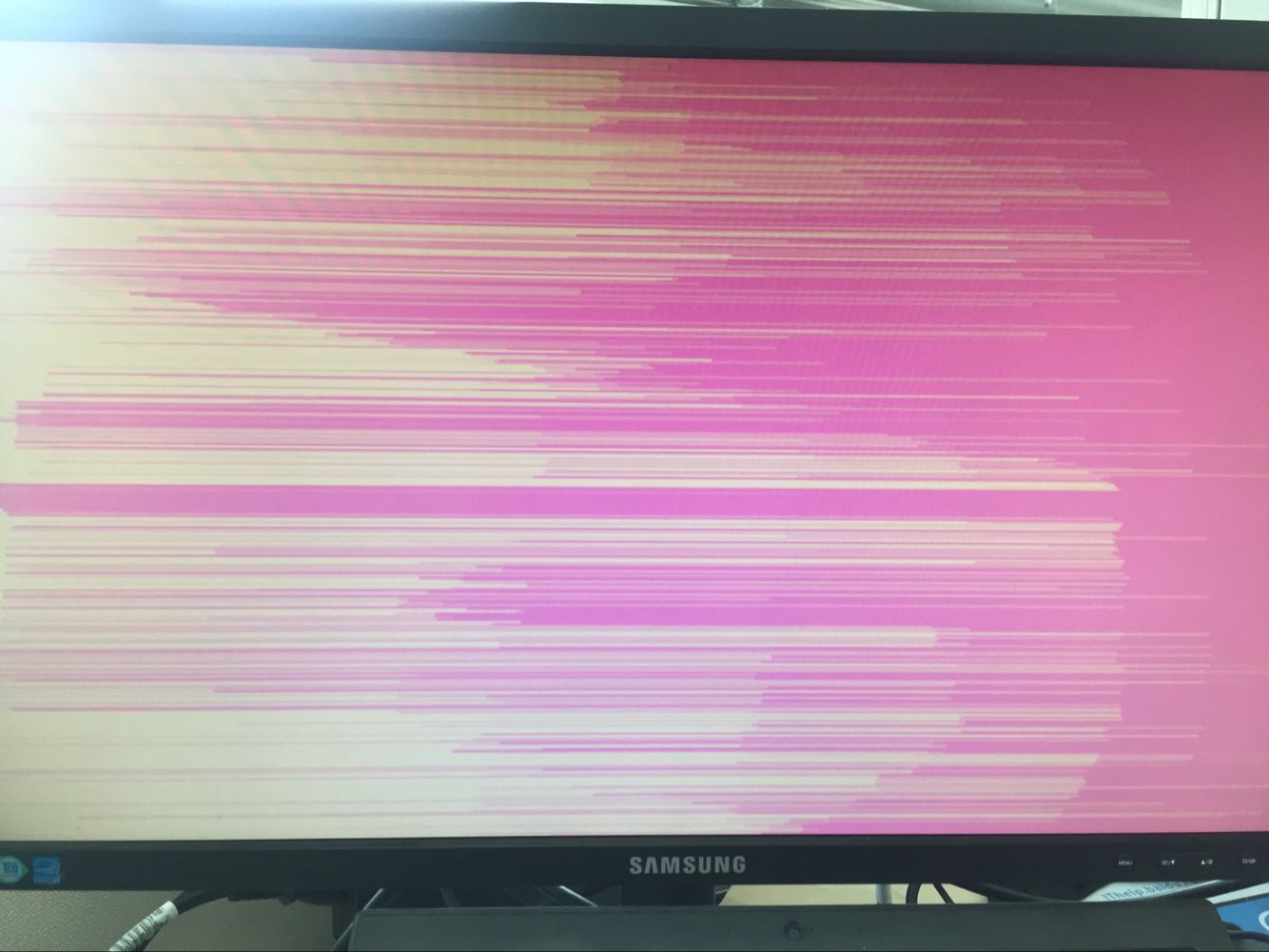

We tried to add a YUV with ISP camera module on R24.2. The code is modified from ov5693.c.
The MCLK and I2c are controlled by ISP not TX1.
Tx1 could only capture one frame as we tested it by the following command.
gst-launch-1.0 -v v4l2src device="/dev/video0" ! "video/x-raw,width=1280,height=720, format=(string)I420" ! xvimagesink -e

Could you try below command.
gst-launch-1.0 -v v4l2src device="/dev/video0" ! "video/x-raw,width=1280,height=720, format=(string)I420" ! nvvidconv ! "video/x-raw(memory:NVMM)" ! nvoverlaysink
Hi Shane,
Thank you for your help.
The command you provided seems work better.
There was no “Error” on TX1 as I tested the command.
However, the image did not show properly and we got error on host terminal.
Below is the error message and the video files will be attached.
We are working on it, and appreciate any advice.

Do you verify the v4l2-ctl to dump more frame and check the raw data is normally?
It’s looks like mipi timing issue cause the timeout.
Hi Shane,
The command you provided worked, as we re-tested it after we fixed our raw data problem.
However, we could not successfully save a mp4 file.
Could you kindly advice a command to save preview into a file?
Below is the command I used. Could save to a file but no image?
gst-launch-1.0 -v v4l2src device="/dev/video0" ! “video/x-raw,width=1280,height=720, format=(string)I420, framerate=(fraction)30/1” ! nvvidconv ! “video/x-raw(memory:NVMM), format=(string)NV12” ! omxh264enc ! qtmux ! filesink location=V4l2_test_n.mp4 -ev
[ 7197.107497] ov5693 6-0036: ov5693_s_stream–
[ 7197.117758] vi vi: vi2_channel_error_status:error 4000 frame 0
[ 7197.141062] nvmap_alloc_handle: PID 11236: gst-launch-1.0: WARNING: All NvMap Allocations must have a tag to identify the subsystem allocating memory.Plase pass the tag to the API call NvRmMemHanldeAllocAttr() or relevant.
[ 7221.244647] ov5693 6-0036: @@@@:ov5693_s_stream++
Thanks,
Could you remove the format=(string)NV12 or change it to format=(string)I420.
Hi Shane,
It works.
Thanks,

Hi PanAndy,
Sorry for the late reply.
I assumed your question is related to “the image did not show properly and we got error on host terminal.”
It was caused by our camera module setting problem and CSI signals not stable.
Also, it’s better to make sure the capture resolution size is the same as your camera output resolution.
Basically, please follow the commands which ShaneCCC provided. (If you are adding a YUV with ISP camera module on TX1 R24.2)
There are many NV experts could help you out, also the more information about what you did and what you had would help them to understand your problem more.
I hope it helps.
