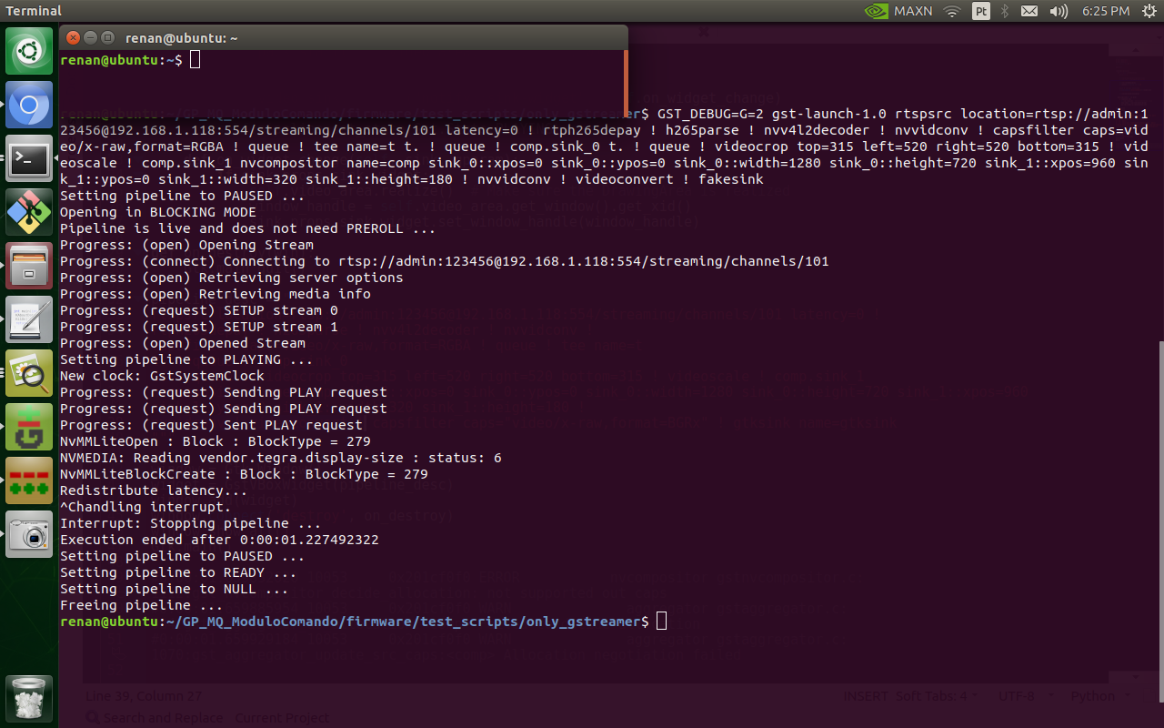

Using fakesink i got this output:
it’s seems right to me
(edit: at first i did not see that you aked for GST_DEBUG=GST_CAPS:5,GST_PAD:5)
now with this comand i have the fallowing log:
fakesing_DEBUG_5.txt (433.8 KB)

For sure:
Here image with GST_DEBUG=2
and here the log with GST_DEBUG=GST_CAPS:5,GST_PAD:5
nvvidconv_videoconvert_fakesink.txt (546.7 KB)
