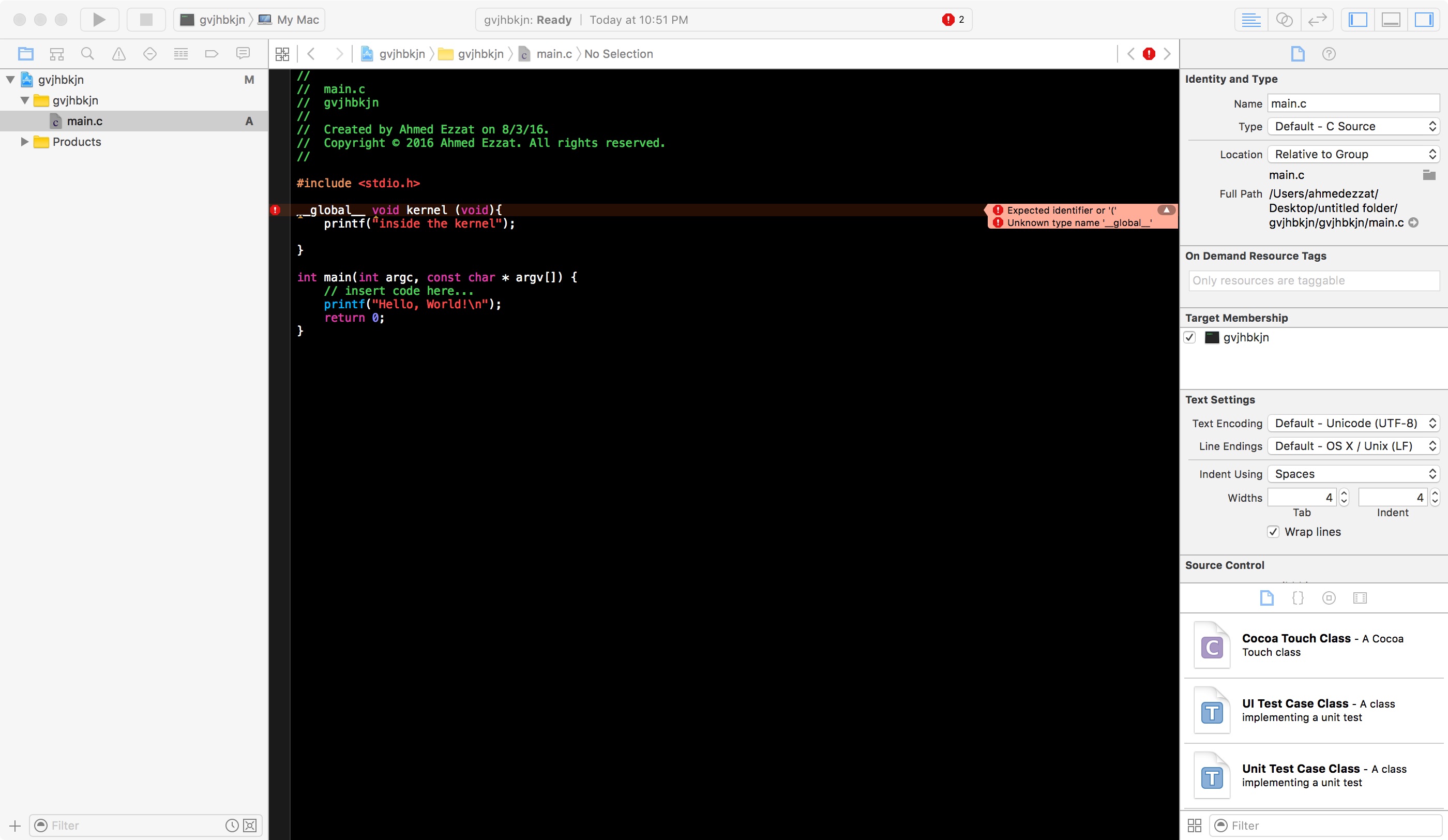

Problems with CUDA on mac
I have installed CUDA 8.0 as shown in here
http://docs.nvidia.com/cuda/cuda-getting-started-guide-for-mac-os-x/#axzz4FrkFxEIS
and every thing went smoothly, but every time I type “global” the Xcode rejects if CUDA wasn’t installed
I’m using Xcode 7.3.1 , CUDA 8.0 , OS X 10.11.6, standard C , command line tools are installed ,
Does Xcode requires some sort of setting to work with CUDA ?
If there was no way to run CUDA on Xcode can it run eclipse or intel parallel studio ? what is the procedure ?
thank you for your help .
Have you followed the verification steps in the CUDA 8.0RC install guide for Mac?
Yes and all verifies ok, then I tried also eclipse nsight release 8 but it doesn’t compile any thing and says “launch failed. Binary not found”
Very well. In section 4.3 of that guide, in the Verification chapter, it advises you to run the deviceQuery sample, and shows what correct output should look like.
What output did you get? (You can copy and paste it into your answer.)

So I would suggest that all did not verify OK, contrary to your statement.
The driver version you have installed is incorrect for CUDA 8.
This issue is probably separate from your question about Xcode. But since you haven’t followed the installation guide correctly, you may want to try and do that, as it indicates various system requirements.

But still doesn’t compile
For CUDA 7.5 (which now appears to be installed correctly) these are the requirements:
[url]CUDA Toolkit Documentation
Your Xcode version that you list in your first comment (7.3.1) doesn’t appear to match the requirements.
Please follow the installation guide carefully.
