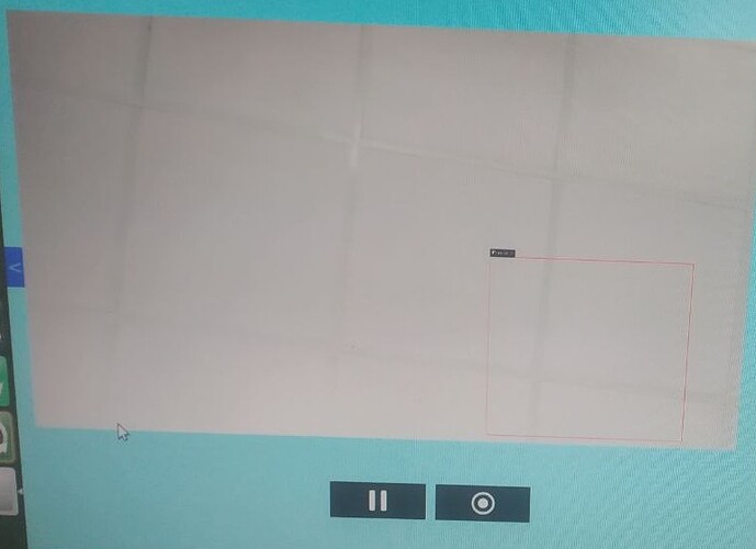

but i want to put video output in specified QML Rectangle which is parent of MediaPlayer object. it seems that i must use qtvideosink instead of nveglglessink. but which plugins should i use to transform the video stream for qtvideosink.
by the way the app is running on NVidia Jetson Nano.

... ! nvvideoconvert ! video/x-raw ! videoconvert ! qtvideosink
It requires buffer copy and may have worse performance.

1- the red bounding box always exists even if no objects are detected. how can i removed it in case of no object detection.
2- i dont need any multiplexer in pipeline. because i have just single source. but it doesnt work if i remove nvstreammux.
Please take a picture of the red bounding box. We have demo code in dsexample to show a dummy red rectangle but the plugin is not used in your pipeline. Not sure why you see it.
For single source you still need nvstreammux plugin but nvmultistreamtiler is not required. May refer to this pipeline:

the object detection works fine in above picture.
the red bounding box remains even if there is no object in picture
It seems like probably nvtracker triggers the issue. You may remove it from pipeline for a try.
