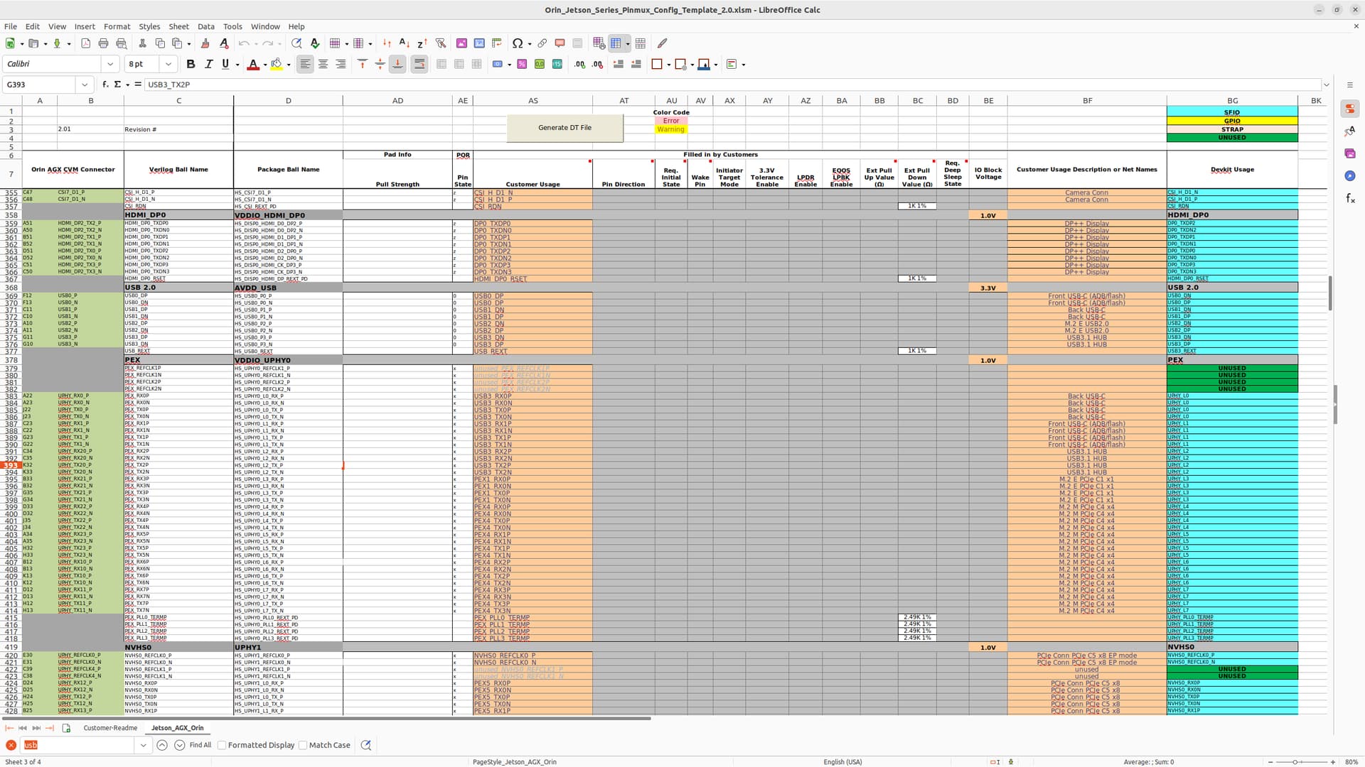

I have a question about a Device Tree Overlay. I’m still trying to get the USB 2.0 ports on my custom board’s SoM up and running. For context, my pin-mux and connection schematic are as follows:
wifi-card.pdf (231.9 KB)
usb_20.pdf (327.7 KB)
I’d like to bring up a Wi-Fi card (labeled USB2_E_N, USB2_E_P on the schematic), but during boot no USB port is created in the system (see the boot_log below),
boot_log.txt (339.0 KB)
so I can’t use any USB device. Because of that, I decided to try a Device Tree Overlay as described in this documentation Jetson AGX Orin Platform Adaptation and Bring-Up — NVIDIA Jetson Linux Developer Guide
I created the overlay shown below and added it to extlinux.conf, yet none of the USB 2.0 nodes are being created.
jetson-usb2-overlay.txt (1.5 KB)
Do you have any ideas why? Is my overlay incorrectly constructed for the pins where I routed the interface? Thanks in advance.

Hello and thank you for your replay.
As you wish this is a full schematic of the board
output.pdf (4.0 MB)
Also there is a full screenshot of the usb data lines configuration in pinmux configurator
I’ll try to do as you say tomorrow and give feedback as soon as possible.
