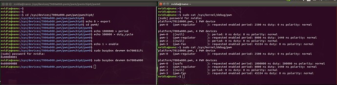

We’ve tested PWM and LED with 3ea of jetson nano dev kit.
The result of PWM function test as below for each JetPack version :
PWM is working => JP-4.6 / JP-4.6.1 / JP-4.6.2
PWM is not working => JP-4.6.3 / JP-4.6.4 / JP-4.6.5
I can see 0x700031fc is set to 0x00000001 after PWM is enabled from jetson-io.py on all of 6 jetpack versions.
The below image from JetPack 4.6.4 installed Jetson Nano Dev Kit.
Register’s values are same for PWM with All JetPack versions what I’ve tested.
But the led light doesn’t come up on JetPack versions above JP-4.6.3
And It has to install with Recovery mode for lower version below JP-4.6.2 if the board is installed for latest version above JP-4.6.3 before.
The installed JetPack version on QSPI affect PWM, either.

Hi sumin.lee1,
Which PWM are you using for LED? (7000a000.pwm or 70110000.pwm)
Have you tried to get a scope to measure the waveform at this moment?
Please share the full dmesg in both release(JP4.6.2(working) and JP4.6.3(not working)) for further check.
We don’t have scope. we can check output through led only now.
And 70110000.pwm device is busy when it export.
I’m testing only pin 32 and pin 33 on GPIO Expansion.
Both pins looks 7000a000.pwm.

Maybe, the issue from device tree as I guess.
Those are device tree from each installed filesystem.
I extracted the device-tree file after the pin 32 and 33 is enabled for PWM from jetson-io.py.
device-tree-jp462.dts.txt (322.3 KB)
device-tree-jp463.dts.txt (322.4 KB)
“lcd_bl_pwm_pv0” are different as below:
// JetPack-4.6.2
lcd_bl_pwm_pv0 {
nvidia,enable-input = <0x0>;
nvidia,pins = “lcd_bl_pwm_pv0”;
nvidia,tristate = <0x1>;
nvidia,function = “rsvd3”;
nvidia,pull = <0x1>;
// JetPack-4.6.3
lcd_bl_pwm_pv0 {
nvidia,enable-input = <0x1>;
nvidia,tristate = <0x0>;
From the dmesg you shared, it seems the similar for all 4 combinations.
Have you tried to use the lcd_bl_pwm_pv0 configuration of JP4.6.2 to JP4.6.3 to check if it could help in your case?
and I found this node(lcd_bl_pwm_pv0) is under unused_lowpower in JP4.6.2, but under common in JP4.6.3.
