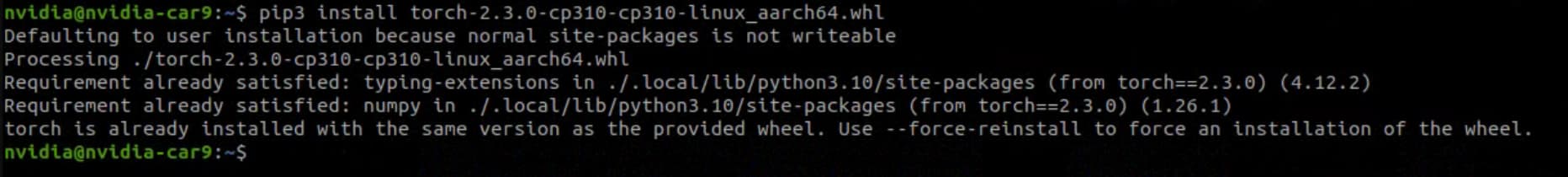

I try installing pytorch 2.3.0 with torchvision v0.18.0
While I install pytorch it said error but the last line said Successful. I have attach image please refer that.

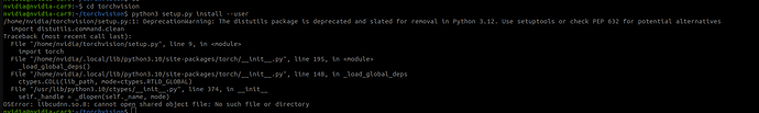

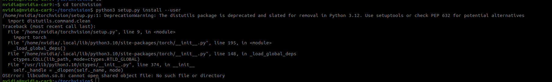

While I was running the command for torchvision, I faced the below error, as shown in image. While installation, I put the version as v0.18.0. To resolve this, I try installing cuDNN from (cuDNN 9.7.1 Downloads | NVIDIA Developer)
Along with that I also try create symbolic link for libcudnn.so.8
sudo ln -s /usr/local/cuda/lib64/libcudnn.so /usr/local/cuda/lib64/libcudnn.so.8
and run: ls /usr/local/cuda/lib64/libcudnn*
I get: /usr/local/cuda/lib64/libcudnn.so.8
Please tell me how to resolve.

Sorry in my last reply I didnt attach the image. Let me do it now.
Please refer the images.
I dont have any issue on running YOLOv11. But below command to install pytorch 2.5.0 doesnt exist:
wget http://jetson.webredirect.org/jp6/cu126/+f/5cf/9ed17e35cb752/torch-2.5.0-cp310-cp310-linux_aarch64.whl#sha256=5cf9ed17e35cb7523812aeda9e7d6353c437048c5a6df1dc6617650333049092
You can follow the Ultralytics guide to install PyTorch and torchvision
