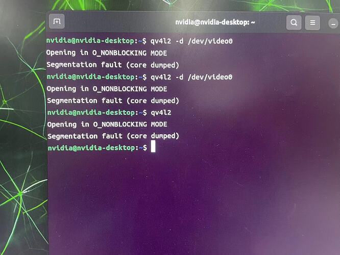

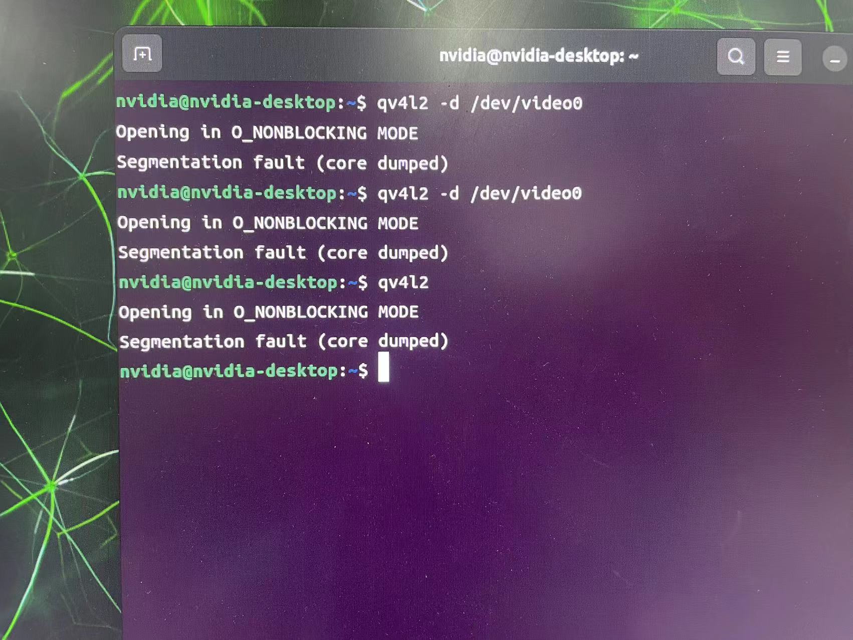

I used AGX orin device, jp6.0 for testing, inserted a USB camera, installed qv4l2 using apt, and executed qv4l2 -d /dev/video0 to open it but failed.
I can open the image using gst-launch-1.0, which means the USB camera is fine.
Please help me troubleshoot

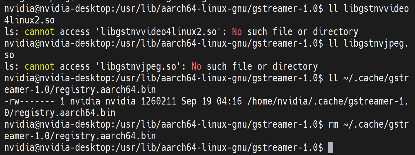

After I delete the corresponding file according to error processing, qv4l2 still cannot be used, as shown in the following figure.
Please share how to install qv4l2 and the command. We will set up developer kit and check.

It looks like it fails in initializing display:
(gdb) run
Starting program: /usr/bin/qv4l2 -d /dev/video0
[Thread debugging using libthread_db enabled]
Using host libthread_db library "/lib/aarch64-linux-gnu/libthread_db.so.1".
[New Thread 0xfffff29df080 (LWP 65821)]
[New Thread 0xfffff201f080 (LWP 65822)]
[New Thread 0xffffe8e8f080 (LWP 65823)]
Opening in O_NONBLOCKING MODE
[Thread 0xffffe8e8f080 (LWP 65823) exited]
Thread 1 "qv4l2" received signal SIGSEGV, Segmentation fault.
0x0000fffff58c714c in glXGetCurrentContext () from /lib/aarch64-linux-gnu/libGLX.so.0
Does the binary have dependency to QT? By default Ubunutu OS is X11. Not sure if the binary can work in the environment.
hi,
Yes, you need to run qv4l2 on the Jetson desktop terminal.
We tested the default availability of JP5.1.2
Please run the command with -R:
$ DISPLAY=:0 qv4l2 -R -d /dev/video0

Please also remove the lib for a try:
$ sudo rm /usr/lib/aarch64-linux-gnu/tegra/libv4l2_nvargus.so
hi,
After I deleted the library as required, the result remains unchanged.
