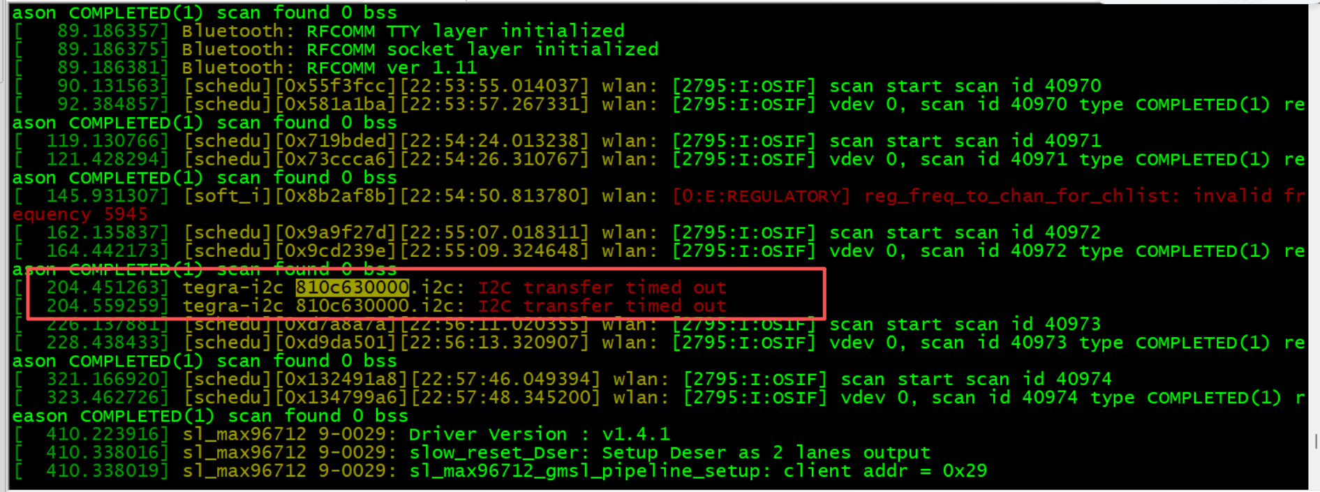

R3840 i2c0 上挂载的设备咨询
hi:
我发现这个上面有个EEPROM,请问怎么去掉这个设备呢,我们自己设计这个总线上没有使用,然后看log 有i2c的报错
[  204.451263] tegra-i2c 810c630000.i2c: I2C transfer timed out
[  204.559259] tegra-i2c 810c630000.i2c: I2C transfer timed out
[  226.137881] [schedu][0xd7a8a7a][22:56:11.020355] wlan: [2795:I:OSIF] scan start scan id 40973

hi:
根据打印看是这个810c630000总线 报错,你提供的eeprom@56在这个i2c@810c640000 上面,是不是搞混了,
Why there’s no 810c630000.i2c: I2C transfer timed out error in this log you shared?
Do you have EEPROM from this interface so that you want to keep it?
那个日志 我随后遇到了 再提供下,现在没有了
There’re no I2C devices under i2c@810c630000 node, and it seems you have disabled it.

If you have disabled i2c@810c630000 in device tree, then there should be no such error like 810c630000.i2c: I2C transfer timed out. Please help to monitor if there’s still the issue.
hi:
我们在压测中
hi:
我抓了一份log,可以看看
i2c-time-out.log (131.7 KB)
Could you run the following command on your board(when you hit the issue) and share extracted_proc.dts for further check?
$ sudo dtc -I fs -O dts -o extracted_proc.dts /proc/device-tree
