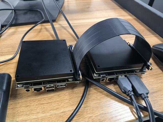

两块agx orin开发板用pcie交叉线连在一起，一块做rc端，一块做ep端，并按照[PCIe Endpoint Mode — NVIDIA Jetson Linux Developer Guide 1 documentation](https://docs.nvidia.com/jetson/archives/r36.4/DeveloperGuide/SD/Communications/PcieEndpointMode.html?highlight=ep#connecting-and-configuring-the-devices) 烧录了固件并做了ep端配置。现在在rc端用lspci命令检测不到ep端的板子。
系统版本：Jetpack6.2 [L4T 36.4.3]，产品型号：900-13701-0050-000，RC端、EP端dmesg日志如下：
请问是什么原因呢？

Hi cdliyijie,
Could you share the block diagram how do you connect 2 AGX Orin devkit through PCIe interface?
Please also share the device tree configurations for both rc and ep sides.

Hi，KevinFFF，
我们用交叉线连接两块板子的插槽：
 ![微信图片_20250528085215_56](https://global.discourse-cdn.com/nvidia/original/4X/c/9/d/c9d0b519546576ed30d19f856570db82c05b19db.jpeg)

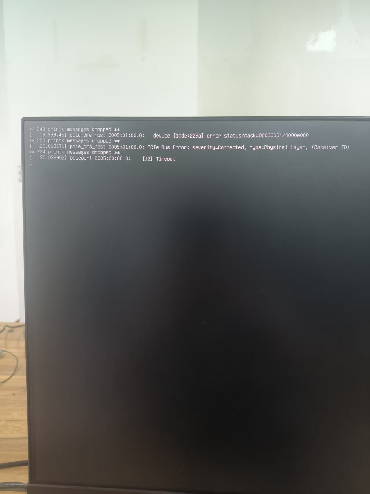

我们更换了pcie的连接线，现在rc端启动报下面的错误：

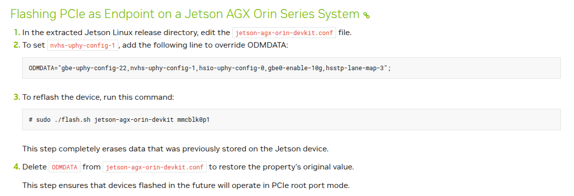

The question here is what kind of “烧写之前将配置文件改成了对应的RP和EP端配置” did you try there..
If you modified the ODMDATA, then our overlay dtbo will handle the device tree content automatically. But if you didn’t apply our overlay dtbo, then such change won’t happen.

是的，我们是按照这个步骤来做的：

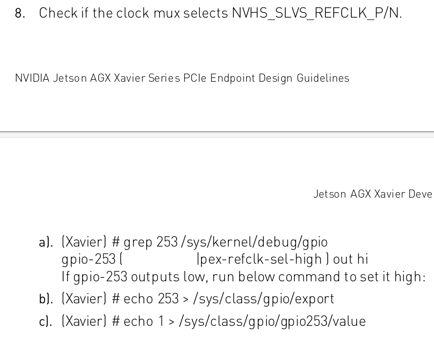

please refer to the hardware design.
Even though it is Xavier doc, it is still applicable to Orin.

![image](https://global.discourse-cdn.com/nvidia/original/4X/3/6/4/364b202a0d1db4baeb2939de593385db7bfc5036.png)
这一步是必须的吗，agx orin的/sys/kernel/debug/gpio里面没有253，系统文件里也没有/sys/class/gpio/export

Those are not needed for Orin.
