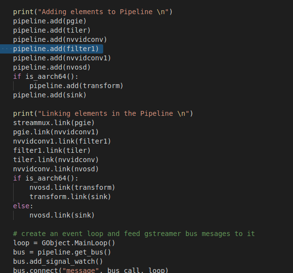

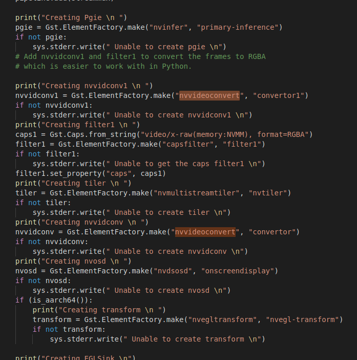

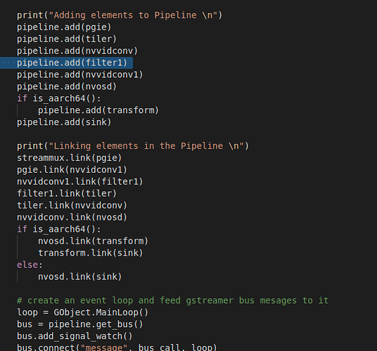

I want to read the original frame from the input stream and draw on it with opencv. I see that deepstream-imagedata-multistream test already has the code that does that
# Getting Image data using nvbufsurface
# the input should be address of buffer and batch_id
n_frame=pyds.get_nvds_buf_surface(hash(gst_buffer),frame_meta.batch_id)
#convert python array into numy array format.
frame_image=np.array(n_frame,copy=True,order='C')
#covert the array into cv2 default color format
frame_image=cv2.cvtColor(frame_image,cv2.COLOR_RGBA2BGRA)
But I got this error
Pipeline construction from main()
I found someone pointing to this solution, but I don’t know how to update the current code according to it.
