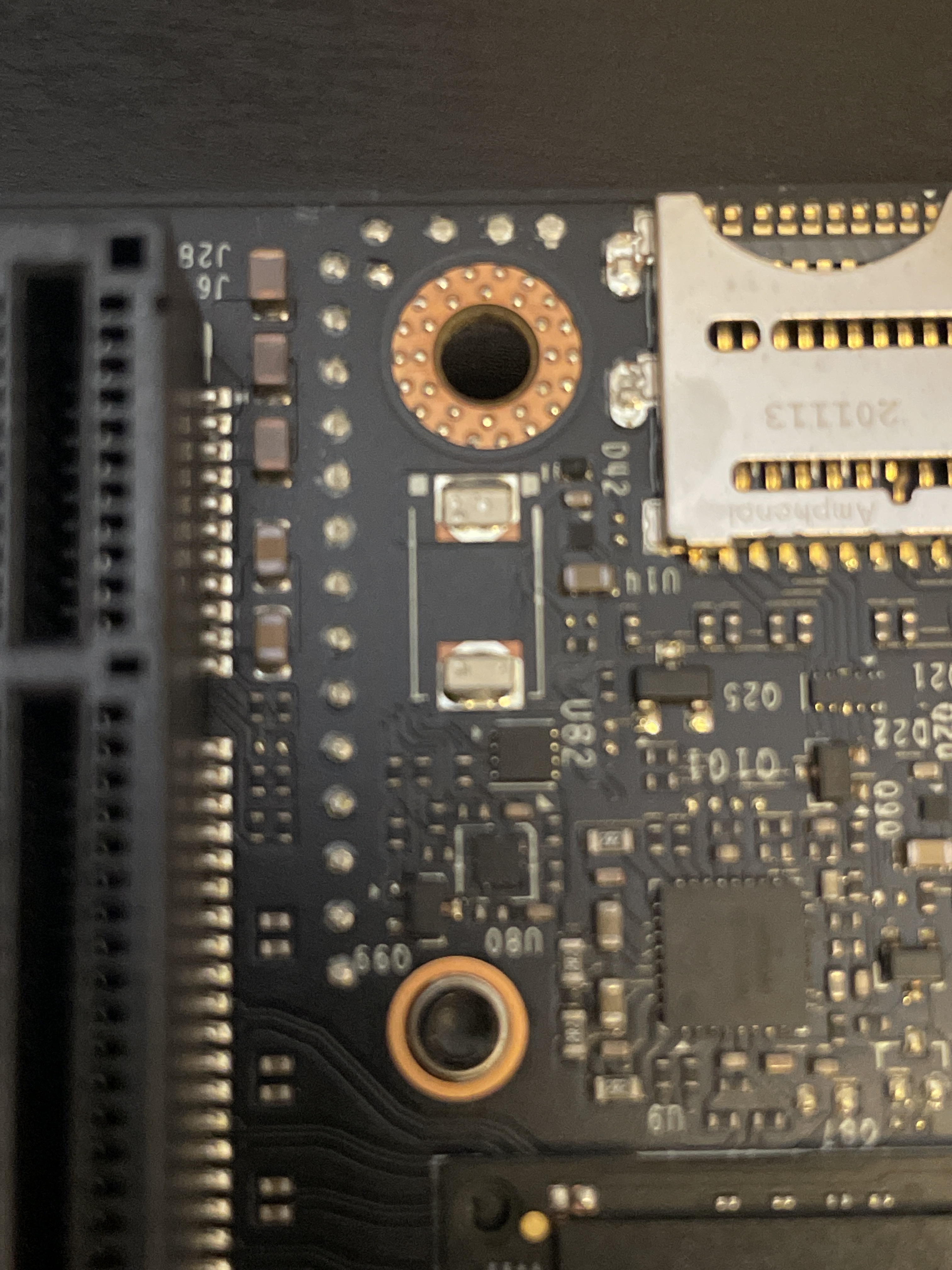

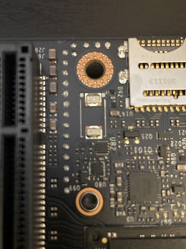

Hey guys, I’m devastated, I was trying to install an m.2 ssd to my carrier board on the AGX developer kit, and when I took the module off, one of the (resistors)? Came off the board. Is it possible for me to reattach this component ? Please help!
this could be a tantal or diode take a look here https://www.jetsonhacks.com/wp-content/uploads/2018/10/SSDInstalled.jpg it’s probably not difficult but somone who don’t know how to solder can destroy the pcb
This is a 100uF/25V TA-polymer cap. You can add a similar one if you can get such component and know how to solder it.
Thanks so much! Ordering one now, And I’ll get it repaired locally as I don’t believe I have the soldering skills required.
