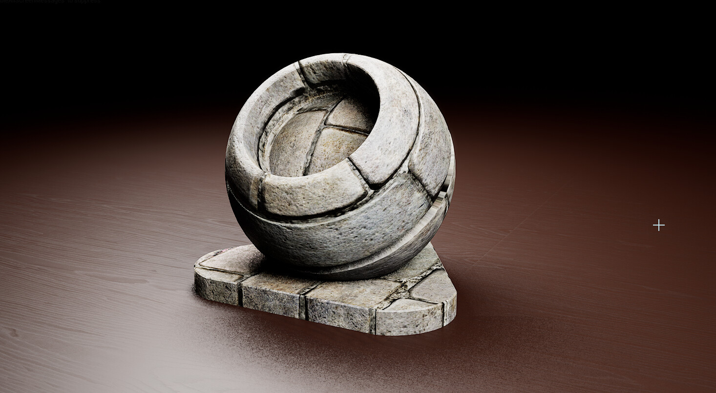

Alright, I’m excited to tell you that we can support this workflow. We’ve tried to make it so that when you edit the USD and MDL you know longer need to “export”, but instead you’re editing in-place. If you want to do heavy-lifting and really change the guts of a material that you’ve exported, that’s another matter that I’m not demonstrating here.
I will show demonstrate with screen shots these steps:
Create a “parameterized” UE4 Material and Material Instance
Apply them to a shaderball level in UE4 and export that as a USD stage (stage, meshes, lights, cameras, and materials)
Open this USD stage with MDLs in Maya, Create, and UE4
Live-edit the MDL material parameters in UE4 and Create and show that they update in Maya, UE4, and Create
Make a material and material instance with parameters (so they don’t require a recompile in UE4 and MDL can make tweakable parameters):

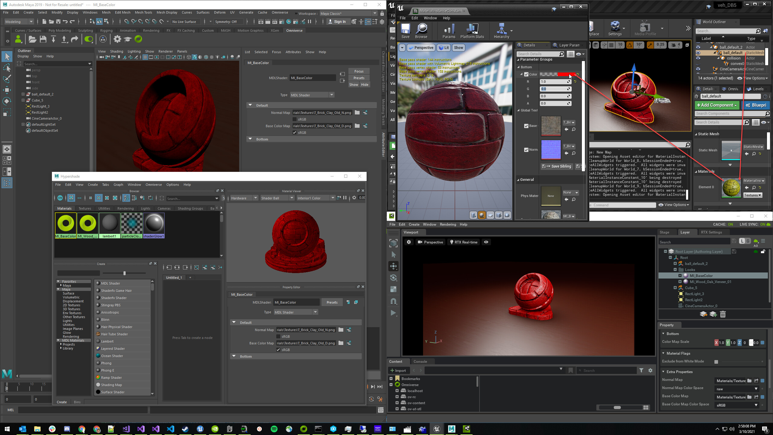

I’ve exported it to Omniverse as a USD stage + MDL materials and opened it with live-sync enabled in Maya, UE4, and Create. I then went to UE4’s material instance editor and made the material’s Color Map Scale red:
The “Color Map Scale” parameter did not display in Hypershade in Maya. I’ll look into why that might be.
When I attempted to change the Color Map in Maya, I could not browse the Nucleus server, and pasting an Omniverse URL into the dialog did not change the material.
