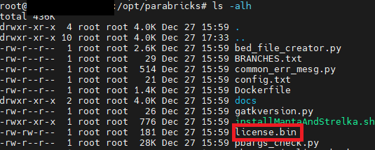

I want to replace the trial license with a new node-locked license file(not a trial license).
The install location is /opt/parabricks. Can I just run the following command?
$ sudo cp license.bin /opt/parabricks/
I’d like to know there are any additional issues or concerns about replacing the trial with the official license? Or do I need extra steps?

Copying the node-lock license file the way you suggest will work just fine.
Thank you for your help!!
