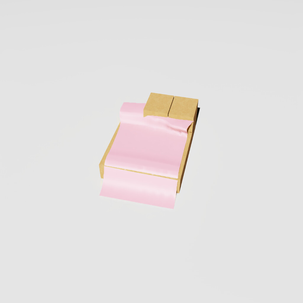

I’m currently trying to create synthetic data containing a deformable body acting as a slipsheet between different layers of cases on a pallet.
I’ve managed to get the physics working during the replicator randomization thanks to this post (https://forums.developer.nvidia.com/t/trigger-randomization/254170/8), but I’m now running into the problem that I need to reset my deformable before the next data point can be captured.
I want to randomize the position of the sheet and afterwards apply the physics again. Currently I’m only able to start the physics simulation once in the beginning and then randomize the texture and position afterwards.
So if I randomize the position of my sheet the result is sadly not usable. Ideally I want the Sheet to lay on the cases below and bend in the front without clipping into the cases.
Is there any way to reset the physics of the sheet through the replicator without instantiating a new slipsheet object and deleting the old one?

Hi there,
from the provided snippet it seems the move_slipsheet function only randomizes the color of the sheet.
If however you managed to the the deformable simulation working in an expected matter, I would suggest to use a different approach for the synthetic data generation, namely using orchestrator.step()in a custom loop whenever you would like to capture the data.
This will mean you will have to disable capture on play (orchestrator.set_capture_on_play(False)) so the data in only captured when you request it during the simulation.
This approach will also allow you to take adantage of the higher level randomization functions from replicator, and will give you the customization capabilities on the simulation.
