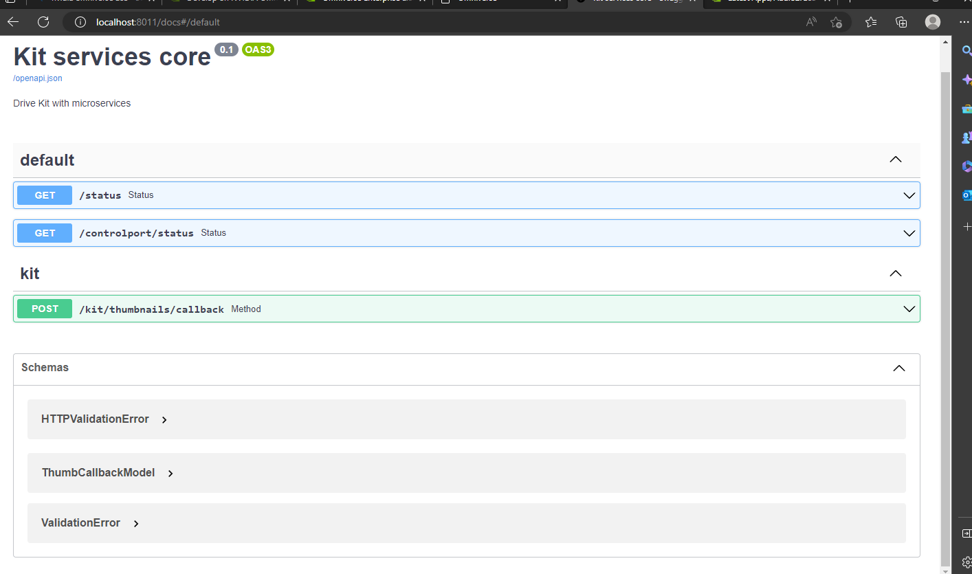

I am not able to view the entire docs at localhost:8011/docs

Did you launch A2F before accessing the docs? The API documentation is a “live” documentation generated when A2F is launched.
yes

Is there any error message when launching A2F?
Could you send us the log file?
It is located here C:\Users\USERNAME\.nvidia-omniverse\logs\Kit\Audio2Face\2022.2

Nothing unsual on the logs, it could be that you have a process already using the port 8011
Would you mind trying this command on a PowerShell terminal and report the output?
Get-Process -Id (Get-NetTCPConnection -LocalPort 8011).OwningProcess
