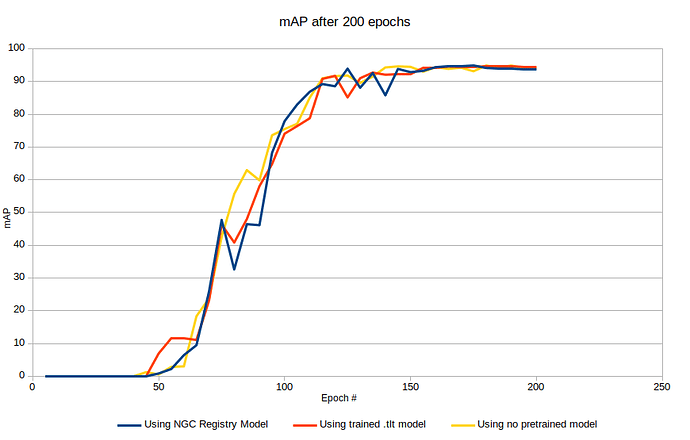

How can we use a .tlt model that we have already trained? When I update the pretrained\_model\_file in the spec with a .tlt model I had previously trained, the mean average precision goes back to 0 as if it’s not loading in those weights.

FYI - the precision is also lost when I retrain the pruned model, even when the pruned model had a 1.0 Pruning ratio.
Here is the command I’m using for training:
```auto
!tlt-train detectnet_v2 -e $SPECS_DIR/detectnet_v2_train_mobilenet_v2_kitti.txt \
                            -r $USER_EXPERIMENT_DIR/experiment_dir_unpruned \
                            -k $KEY \
                            -n mobilenet_v2_detector
This is the training spec file:
```auto

Can you attach your training spec too? May I know more info about your case?
I assume as below, please correct me if any.
1. You train with the training spec, mAP is accepted.(Please paste your result here)
2. You retrain with the unpruned tlt model, and modify into above retraining spec, mAP is 0.

I attached the training spec in my previous post…did you mean my retrain spec? They are actually the same, just that in my “Training Spec” I am using a previously trained, unpruned model as the `pretrained_model_file` and in the “Retrain spec” I am using the resulting pruned model as the `pretrained_model_file`.
Here are the situations I’ve tried:
1. Train with training spec where I use the pretrained Mobilenet V2 model from the NGC model registry (`.hdf5` filetype). The first 50 epochs all have 0% mAP, and eventually I was able to achieve 94% mAP after several hours of training.
2. Prune the model
3. Retrain the pruned model. The first 50 epochs are all back at 0% mAP and it takes several hours again to get back up to 94% mAP
I’ve also tried:
1. Train with training spec where I use my own previously trained model, this time it is a `.tlt` file. Again, the first 50 or so epochs are back to 0% mAP, even though I can confirm that this `tlt` model used as the `pretrained_model_file` has an mAP of around 94% when I evaluate it separately. I was eventually able to achieve around 94% mAP after several hours of training.
2. Prune the model
3. Retrain the pruned model. The first 50 epochs are, again, all back at 0% mAP and it takes several hours again to get back up to 94% mAP.
My theory is that the weights aren’t actually being initialized, but I cannot confirm this by looking at the logs during training.

Ok, @Morganh I’ve completed the 3 experiments and the results appear to support the theory that the TLT isn’t initializing the model weights at all. I have the same training performance whether I use the NGC pre-trained model, my own trained model, or nothing for the `pretrained_model_file` parameter in the spec file. I have saved each of the specs files and the training logs and can attach here if you would like to see that–they are all very similar to what I’ve already shared above.
Again, these were the 3 experiments I ran:
> 1. Using the NGC registry ( `.hdf5` model file) as `pretrained_model_file`
> 2. Using the resulting model from #1 above ( `.tlt` model file) as `pretrained_model_file`
> 3. Using nothing for `pretrained_model_file` … (the documentation does not state that this parameter is required so my assumption is that the weights will be initialized randomly if no value is given for `pretrained_model_file` )
Here are the training results on a graph of mAP every 5 epochs:
 ![training_results](https://global.discourse-cdn.com/nvidia/original/2X/e/efb137e60cf1d193c925a1b09ba6d984abae5325.png)

**Author:** ![Morganh](https://sea2.discourse-cdn.com/nvidia/user_avatar/forums.developer.nvidia.com/morganh/32/9748_2.png) [@Morganh](https://forums.developer.nvidia.com/u/Morganh)\
**Post date:** [March 23, 2020, 1:08pm UTC](https://forums.developer.nvidia.com/t/retraining-with-pretrained-tlt-models/110030/17 "2020-03-23T13:08:04Z")
</div>
Hi harryhsl8c,
Could you attach all the spec files along with the log here?
More, did you try other TLT network, like SSD or Faster-rcnn?
**Post date:** [March 24, 2020, 8:39am UTC](https://forums.developer.nvidia.com/t/retraining-with-pretrained-tlt-models/110030/20 "2020-03-24T08:39:06Z")
</div>
Hi harryhsl8c,
For the reason why the first 50 epochs are all back at 0% mAP, it results from soft\_start parameter in the spec. And you already set training epochs to 500, so, for the epochs which are less than 0.1\*500 = 50, the mAP is not high.
```auto
soft_start: 0.1
Make soft\_start smaller will let mAP increase earlier.
And also from your previous test result graph, I can see the mAP at 50 epoch with pre-trained model is higher than using no-pretrained model. Therefore, it proves that pretrained model helps.
